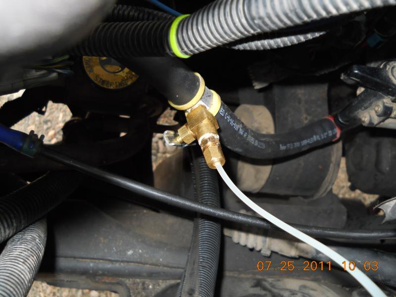

I have a quick fuel pressure question.  I recently noticed that my FP gauge reads between 14-14.5 psi while driving, it was reading 17psi-18psi a few weeks go.  I assumed that the filters may need replacing, although they only have 2500 miles on them if that.  I have not swapped filters out as of yet, but noticed something odd today.  I bumped the engine over and FP gauge showed 16psi, but when I fired truck up the gauge would fall to 14ish psi.  Would the VP44 drawing fuel cause the gauge to drop.  I have adjusted the Airdog 4G in the past to show the 17-18spi while running.  the gauge "T" with sensor is approx 20 inches away from VP44.

I would get a mechanical test gauge and see if maybe the sensor for the EV2 might be going bad. Do you have any protection for the sensor from the pusles from the VP?
I use a needle valve barely cracked open to protect my mechanical gauge. The electric sensors need this or something similar for the same reason. @Mopar1973Man has the EV2's also, as others and use a different method to accomplish the same thing.
Sensor needs about 5 foot of tubing from the snubber. The travel distance helps with stability and protect the sensor.
Adjustable fuel pressure regulator you want to cycle the screw full loose, full tight, the reset you pressures. Some times the regulator sticks.
Check ball and spring. It possible the spring was bent in a manner the prevents the check ball to stay centered. Then you'll get that random drop. I'm currently in this boat.

1/8 inch air brake line at least 5 feet.
PTC (Push To Connect) to 1/8 inch NPT.
I'm not using compression fittings. PTC fittings are super nice you can just push the tubing into the fitting your done. To remove push the collar back and the tubing is released from the fitting.

My push lock type fittings had the plastic tabs, not like the ones above. They were all leaking on the isolator and snubber in less than 2 years except the one behind the gauge in the truck. The isolator was causing a bad reading on the gauge, off by 7 psi when tested on the schrader valve under the hood. I decided to not use the isolator and removed it.
