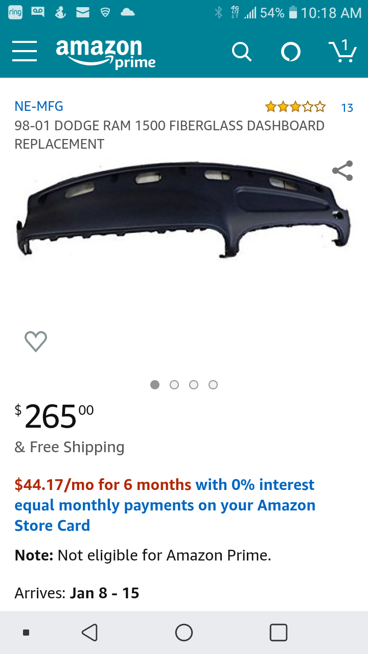

 I'm really looking at the fiberglass one from Amazon. Some say fits good, others not so good but glass seems better than plastic to me. Don't know how to add a link so pic will have to do.

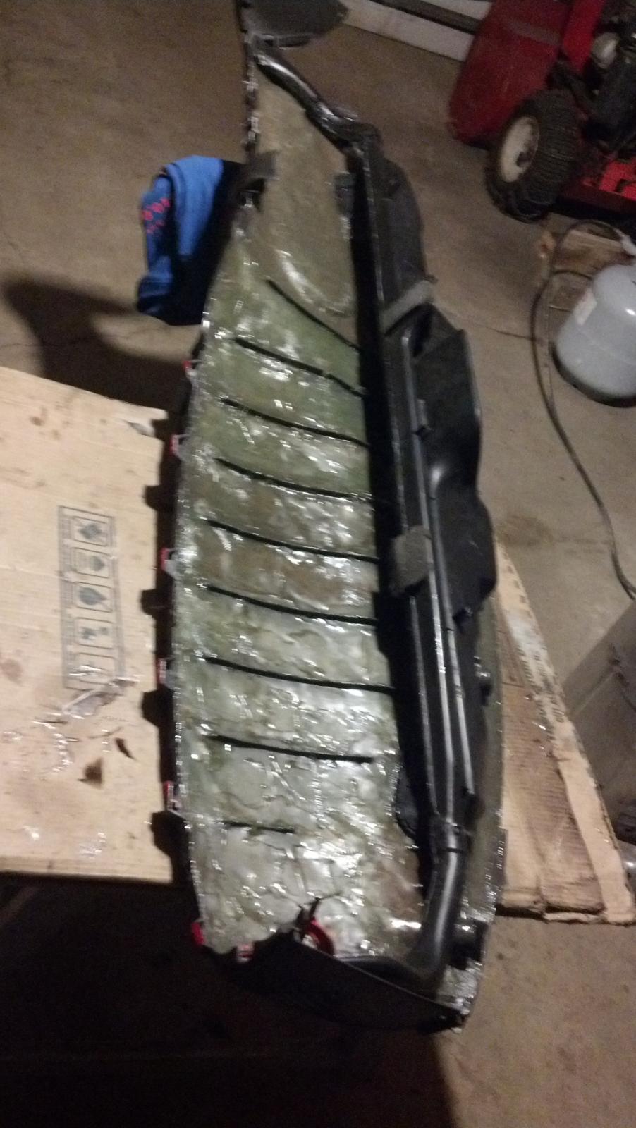

    This was my temporary fix, still using it for a moment, got more cracks since but none of it has fallen in yet.
  • After reading the reviews on Amazon for the  one shown I would not touch it. Even the 5 stars reviews, all 2 of them had issues. Seems the manufacture has tried to overcome having to pull the dash for

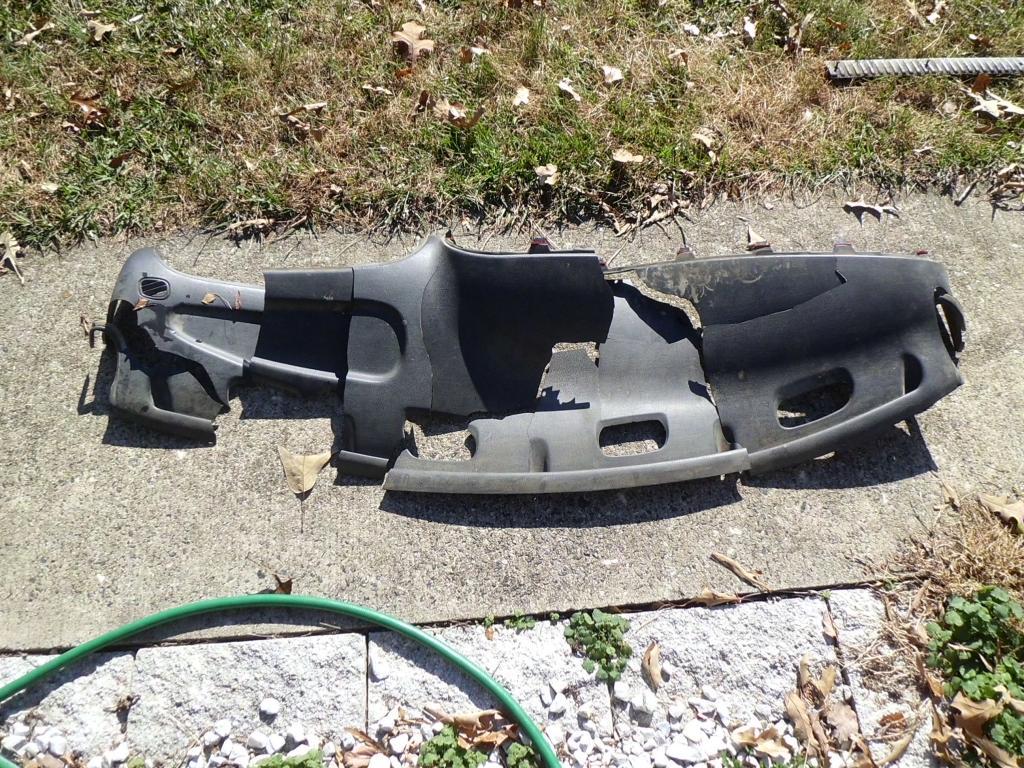

I used the one from LMC truck my self about 7 years ago. The fit and color was spot on. About $300 back then to the house. Shipping was pricey and I bought the extra washers they sold then for use on the screws at the windshield. It gas geld up just fine so far. Others offered at the time had alot of mixed reviews like you are seeing.

After reading the reviews on Amazon for the  one shown I would not touch it. Even the 5 stars reviews, all 2 of them had issues. Seems the manufacture has tried to overcome having to pull the dash for install. There are a good many screws that attach from the back in a factory install. To many weird things on the install. This is a good time to pull the dash and replace it along with pulling the HVAC box and doing a rebuild on it also. It is worth the effort. Just not sure I want a replacement that requires trimming and gluing things that should be screwed.. Just my opinion.
You can read them for yourselves.
https://www.amazon.com/98-01-DODGE-FIBERGLASS-DASHBOARD-REPLACEMENT/product-reviews/B06X931MKB/ref=cm_cr_arp_d_paging_btm_next_2?ie=UTF8&reviewerType=all_reviews&pageNumber=2

I've read the reviews. I have already replaced heater core and evap. At the time didn't have the cash for the dash. I like the idea of fiberglass but also leary of fitment. I'll be painting it or doing a padded dash top and that will hide a lot. Was considering using marine grade vinyl or something like that. Also wanting to build in gauge mounts for 4 gauges over instrument cluster. I think fiberglass would be easier to work with than plastic.

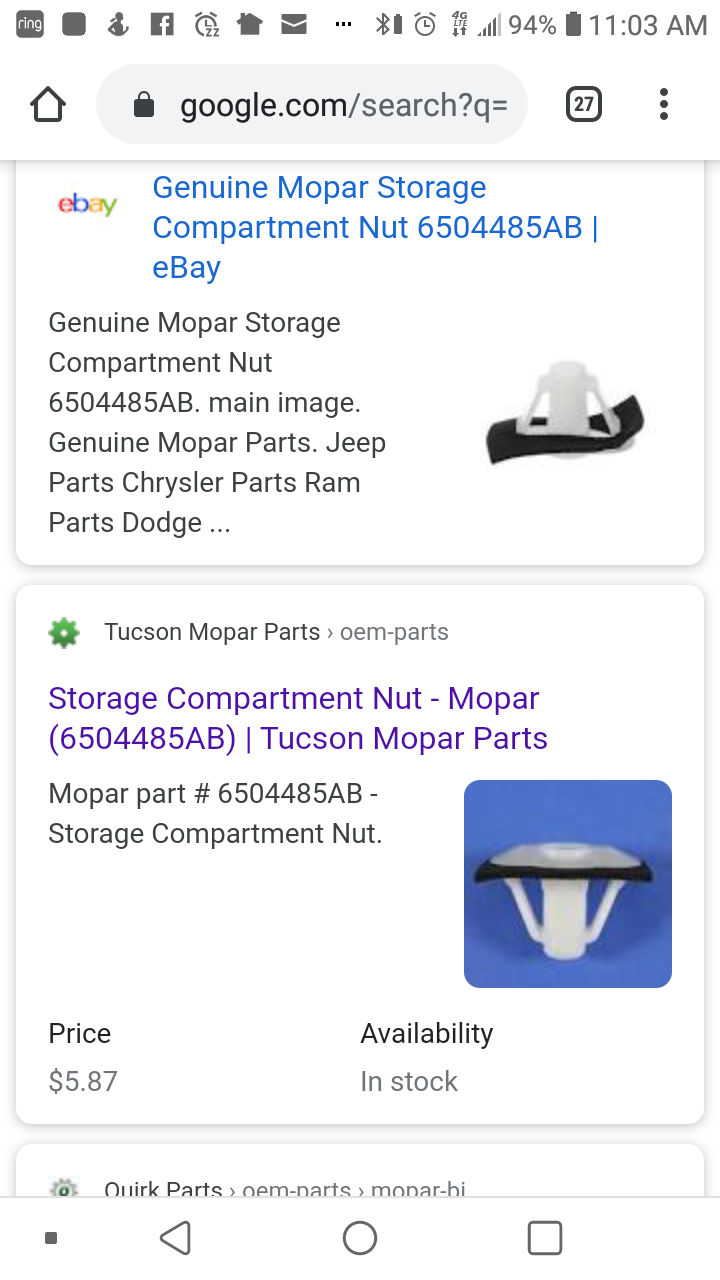

 Do the ones from LMC or Genos have the screws that hold the ductwork to the dash?
The LMC was a duplicate of the OE. Every screw that came out of the OE went back into the LMC replacement.
No cutting or fitting of any kind needed.
Ok i didn't realize that. Thought they left out the vent screws. Is it made out of better plastic that the original?

As i remember, yes. Mine has near 7 years sitting in the sun. The OE did not start cracking until 9 or 10 years old. Never lost any big chunks of it until i pulled it out and as you can see it had a lot of cracks.post-10340-138698194474_thumb.jpg
IIRC you have to pull the dash to install it. Pretty sure you cannot get to all the screws from the front.
Looking at yhe dates on pic I did thus back in November of 2012.
Now thats what 50 pound dash pad looks like. I smeared a bunch of silicone on the back of my dash bezel to hold it together. Worked pretty good but I was scared to to pull it off for anything. The top was very fragile.
I did that on my 97. 4 layers of glass mat. Worked great but the 01 was way beyond that when I got it.

Yeah I kinda cut it in time before it was in pieces, had cracks but nothing broke yet. I can't see myself putting a puzzle together. If it was all busted, I'd probably get a new one and from what I read I'd go with lmc. That day is coming but I might try some type of leather over top yet with glue. That fiberglass actually reduced the engine sounds just a little, enough to notice but not enough to do it for fun.
