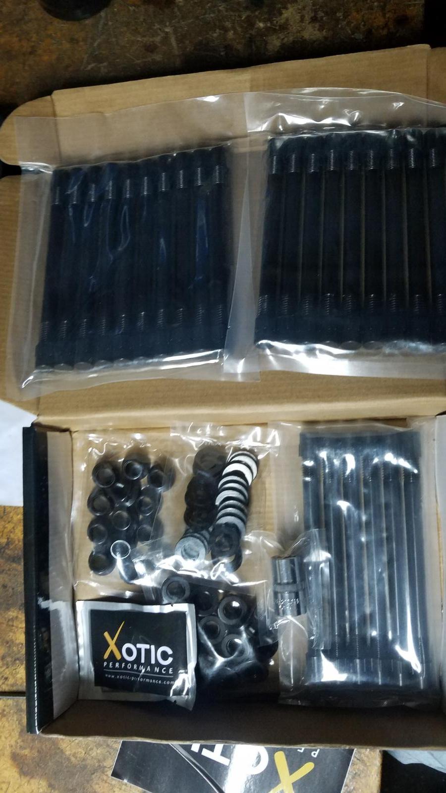

I left about 1/2 turn out but after torquing to 125 foot pounds I'm pretty sure they bottomed out. I lubed both ends...
I wondered about lube on the threads going into block, but it doesn't mention it, threads were clean, screwed by hand to the bottom. didn't think they should be loose though. so I used the Allen wrench they provided just to snug.  Think I'll pull them out and lube them. Thx Mike!
Edited by Blueox01
Reason why. When I pulled the studs out the long studs on the outside of the valve cover has some rust started and I had to clean the holes out and clean the threads. I lubed the threads on the block end to retard rusting in the future. First install I did it dry and wishing now I didn't. The other thing I bought a 10oz bottle of ARP lube for install instead of the little tiny 1.5 blister pack. This way I could really put as much lube on everything as I wished.
Thx, Mike. That's what I'm doing, just think I don't want studs to have any "wobble" when torquing the nuts, so I'm gonna bottom them without a torque. I can really see the difference between the Cummins head gasket Vs the Mahle. Used my Porta Crane to set head on, very little adjustment to get it to fall on alignment dowels.
I was always told not to bottom out studs because of how they grab the threads. Trying to picture it in my mind if it matters :think:. I used motor oil on bottom threads and anti-seize on not threaded part to keep rust away, next time if I'll do it I'll put some of that fluid film on them :whistle:
1 hour ago, Dieselfuture said:
I was always told not to bottom out studs because of how they grab the threads. Trying to picture it in my mind if it matters . I used motor oil on bottom threads and anti-seize on not threaded part to keep rust away, next time if I'll do it I'll put some of that fluid film on them :whistle:
Haven't torqued it down yet, but both you and mike gave same advice, so I backed them off a little, but I was of the mindset that the clamping force should be on the nuts being torqued, and not the studs turning in the block.

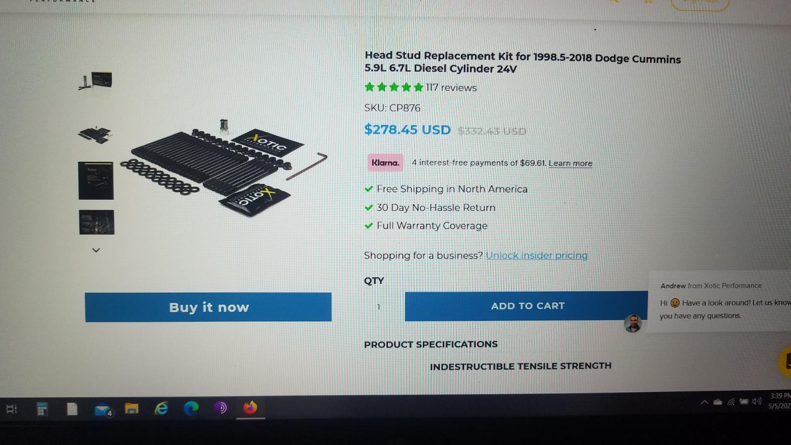

On 8/5/2021 at 12:56 PM, 01_Cummins_4x4 said:
@Blueox01 How are the Xotic head studs working out for you? Any issues?
Great so far, but only have about 20k on them.
