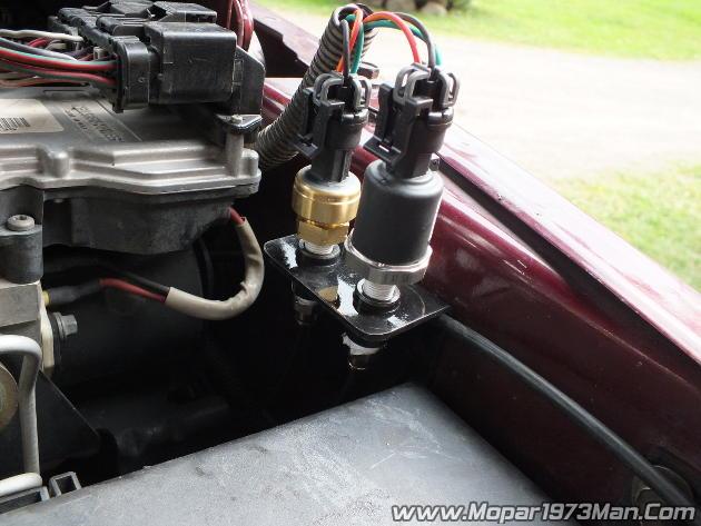

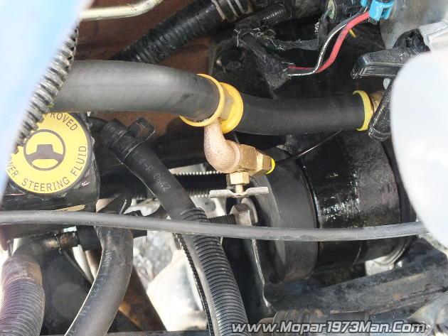

Hence why my set up is on the fender for this exact reason...
Now I can unscrew the fuel pressure sender add a tee and hook up my test gauge and my sender back and then go for ride and test the a-pillar gauge in real time without the fuss or mess.
I've even got all the fitting for any system I've got to tie into...
As for my protection its...
Tap point in-between the VP44 and the stock fuel filter. Needle valve for emergency shut down of fuel in this plumbing then a snubber. I used PTC (push to connect) fittings. Then 5 feet of 1/8 inch air brake line the over to my relocation bracket and sensor is last. After the needle valve you'll see a brass fitting that is the snubber (sinstered metal).

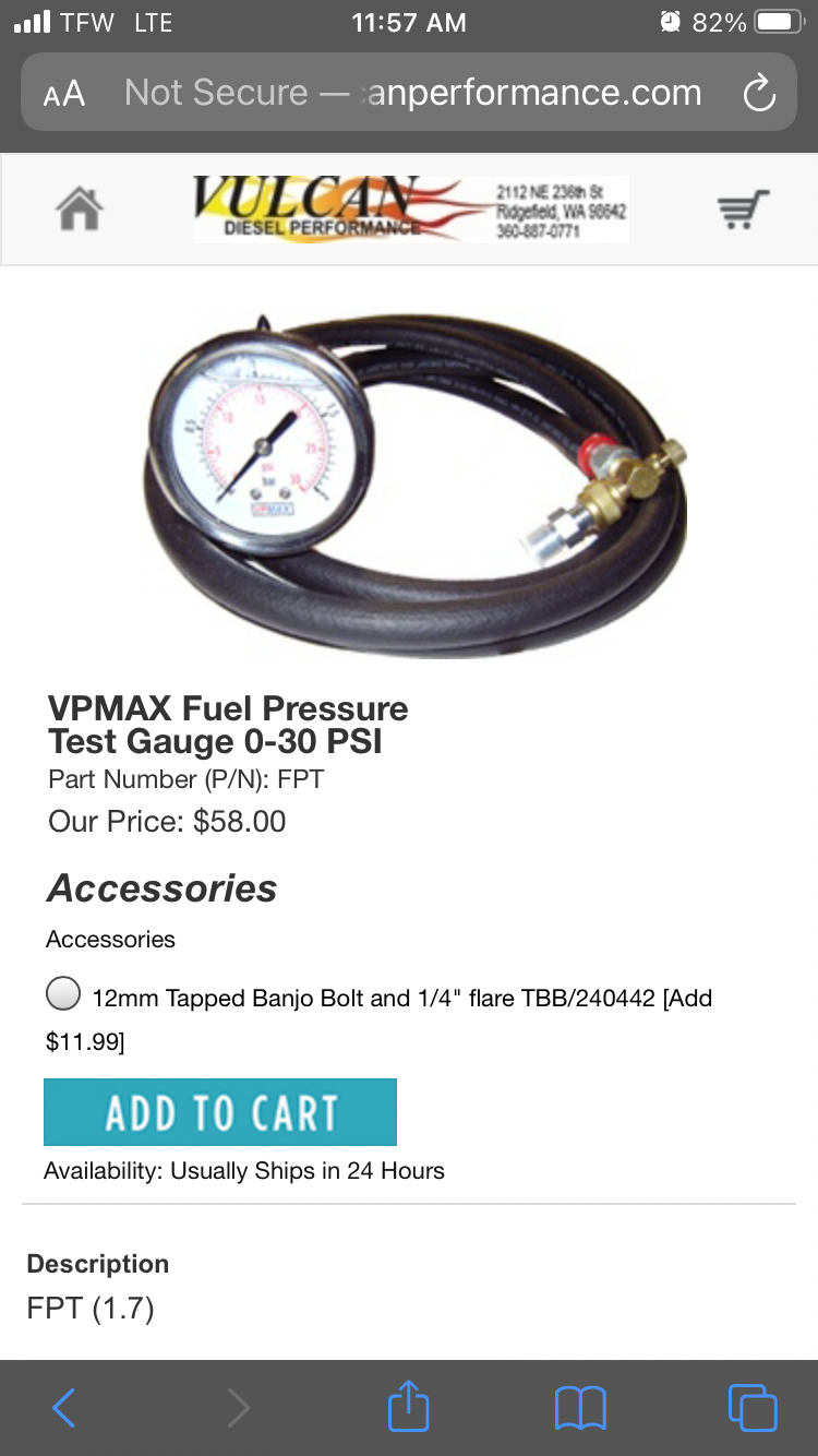

378A04B3-74E5-4142-9E6A-C2CF94676A34.png.41b3c264fe07b1847c8e9e547ebff5ed.pngI ordered the vpmax test gauge kit from vulcan. So will do some testing once it shows up. Thanks all for input so far.
Has anybody rigged up a permanent test spot that could be used. Basically hook the test gauge up as needed. I was thinking of getting a tapped banjo bolt to use at the VP inlet and put a needle valve on the end of the banjo that could be opened and closed as needed. Use that needle valve to hook my test gauge up to.

I received my test gauge from Vulcan on Saturday, and immediately did some testing. My sender does not appear to be the issue as the test gauge was showing low pressure as well, 14 PSI. My thought was to buy a new check valve as one part in my check valve has a small wear groove in it, the poppet. Unsure if it is causing the issues at this point, but worth replacing. The check valve on Glacier Diesel's website is right at $70. I did some digging and was able to find what I hope is the exact replacement check valve for a cheaper price. Through my research, it appears the check valve is an Enderle check valve, unsure if Enderle is the brand name or not. The check valve I purchased is 6AN, and comes with the springs for 17psi. In the check valve, it appears there is only two wear items, the spring and the poppet. The website I found these parts on looks like a drag racing website on the west coast, good vibes racing. I have already received tracking for my order. I purchased both a new check valve, and a new poppet. Once these show up, should be a 5 minute deal to swap these out. I also see an aluminum bodied check valve, and it has a stainless steel poppet. In this instance Im not sure if the brass body or the aluminum body would be better. Both brass and aluminum are softer than the SS poppet. Currently I dont see any wear on the Brass body insides, just the poppet itself.
