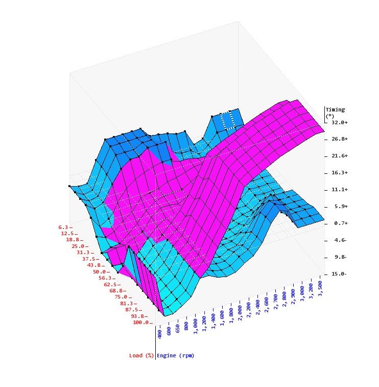

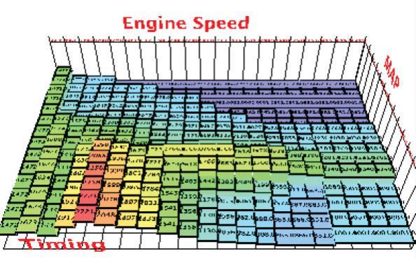

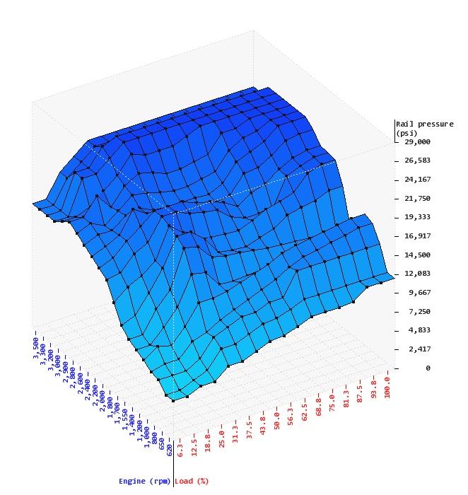

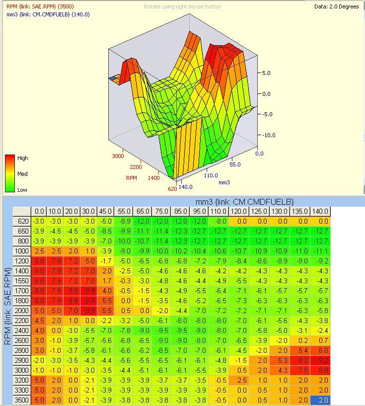

I built a timing calculator that takes pulse width and rpms into account. I think tell the calculator how much fuel I want injected prior to TDC and how much after. Other than low rpm/load and cruise I run about a 50:50 split. The calc then tells me what to set the timing to. The split would be different on a single event motor (VP/Ppump) based on ignition delay being greater without a pilot, so it's not apples-apples, but apples-apple cider. A 12V p-pump will have more ignition delay than a 24V p-pump for the same mm3 and boost, because of piston design and flow differences. 5 psi of boost on a 12V is going to be less flow than 5 psi of boost on a 24V, so the 24V will see greater per-igntion cylinder pressure and temperature, and thus a quicker ignition. The calculator cannot be used on a mechanical injection truck, unless you know how long the injector is open at say 100mm3 at 2000 rpms (pressure and volume effect duration/pulse width). The way the calculator works is you tell it the %age you want injected prior to TDC. So 0% would start injecting at TDC (0.0°), 100% would finish injecting at TDC, 50% would do 50% before TDC and 50% after, 500% would injected it quite a bit before TDC (if it were a 1000us injection event then it would start 5000us prior to TDC and end 4000us before TDC), -500% would start a long time after TDC (if it were a 1000us injection event then it would start 5000us after TDC and end 6000us after TDC). The calculator knows crank and converts us to degrees of timing based on crank speed.So as an example I was running ~200% of my fuel being injected prior to TDC at cruise speed and was getting too much negative torque (pressure building before TDC), so I retarded it to ~100% and mileage went up. As fuel increases ignition delay decreases, as rpms increase ignition delay decreases, in terms of degrees but not always in us. So you need to account for that. A 50:50 split will have low timing at low fuel/rpms and high timing at high fuel/rpms, maybe a 20° difference from 10mm3 at 3000 rpms to 140mm3 at 3000 rpms.What is your advertised mm3, rated rpm, and stock timing?
Well heres my dilemma... Nobody can tell anyone what the timing should be on a given 12V. People say 16 for mileage and not to go over 18 or you'll blow a head gasket. I am not too sure about either one of those things... I ran advanced timing though someone set it wayyyy back when I didn't know anything I guess 3 years ago and they just assumed it was at the stock timing and popped the pump gear off and turned the engine a few degrees then put it all back together and charged me $150. The guy sure didn't confirm anything so it could have been at 20* for all I know. When he was done, it knocked (not as bad as a 24V) and had a lot of top end power, so I was happy. I didn't know the difference as to what he had done so how could I not be happy, it had power.
However, it started like crap and after talking with everyone on CF they told me that was not a characteristic of being advanced to 16, but rather a 20*+ characteristic. This thing was starting at 50F as if it were -40F out. Then I figured everything out myself and set it back to stock. The starting problem was solved but the low end power was ungodly. I couldn't believe how much I had lost. But alas, I had set it by doing some shadetree instructions on CF and when I set it again based on the injection pump pin, it was at 2* ATDC.... So I set it back to stock though I used the valve overlap to guesstimate TDC, but this appeared to get me pretty close. Then I finally figured out the valve drop absolute TDC thing and the spill port timing thing and it was pretty close to stock value IIRC, this time I set it right at 13.5* (which is the stock value actually) and I think it runs perfect.
So, back to the dilemma.... Actually you tell me what you need and if it's even possible to do this. I know injector nozzle sizes, plunger sizes, delivery valve sizes...Hell I have an entire P7100 on my desk. I don't want to burden you so if it's an issue then don't worry about it. But if it's even possible, I think you could get a formula and then make an excel such as this.
Posted Image
This would help the whole world since people with 4.10's and 3.55's are both following the same 16* rule even though they are 500RPM apart at the same speed and load is different too. I for one never get over 2000RPM much. Thing is there just isn't anything more than a seat of pants to tell us where to set timing.. Being static makes it worse since guys who run 3000RPM all day can't run that kind of timing since then it will start like crap. In the summer it wouldn't really make a difference and with the trailer I run at 70mph since it's always interstate and that's 2100RPM. The RPM is so high that you can just set the cruise and let it do whatever it wants and EGT is never an issue up any hill you have. But I run 1800 without it, so it would be nice to see where it needs to be in both instances.
