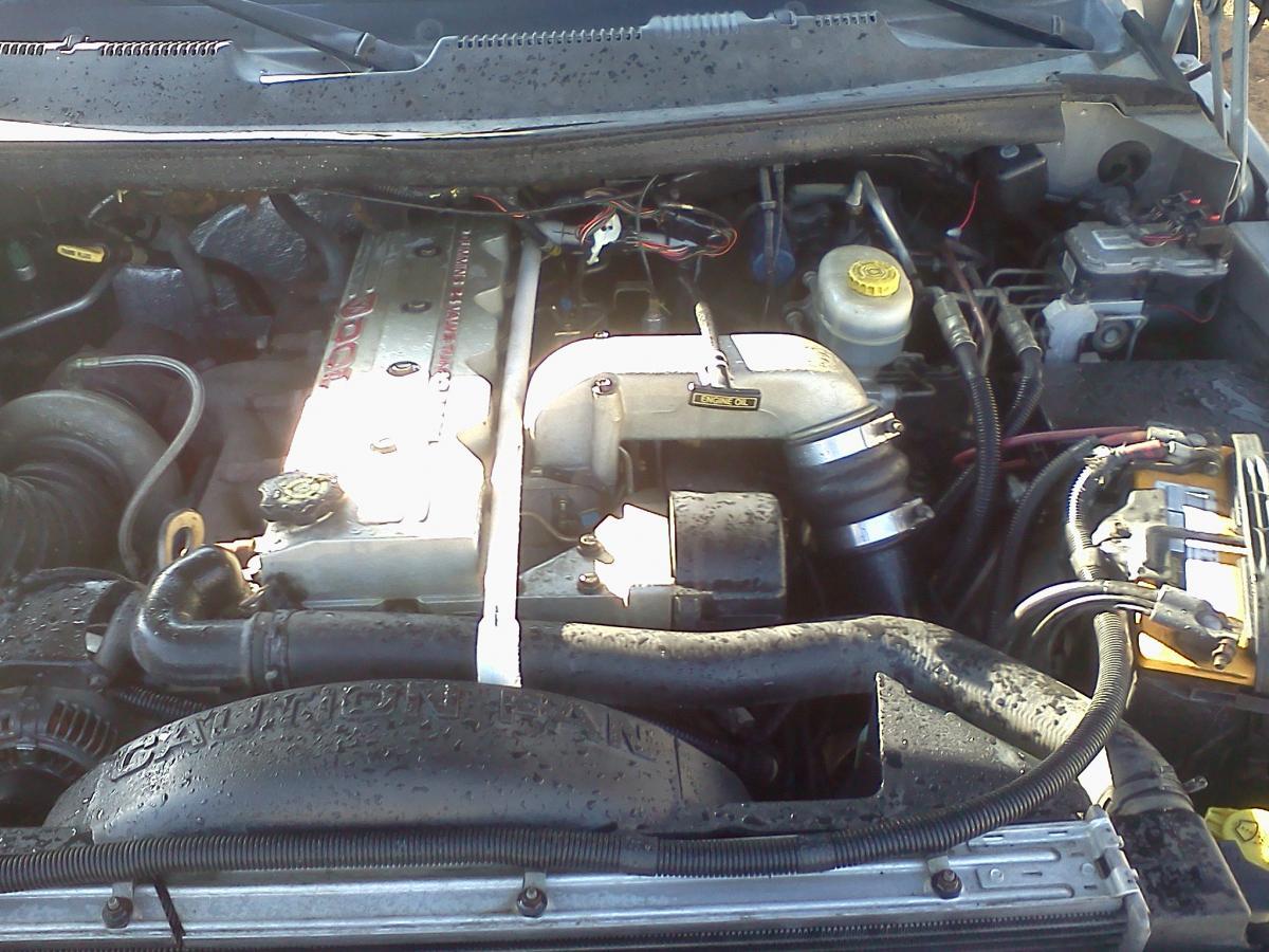

well i started last night taking the bumper and bumper guard off, that took some time. but i started taking everything off today. taking my time and putting everything in marked Baggies so i dont have a hard time remembering where everything goes or having to go to the book every ten minutes. . can somebody tell me what i have to do to separate it from the transmission. do i have to drop the trans too? i have been taking pics so maybe  they can help some one who has never done this before like me. also i noticed some oil in my turbo cooler tube and on the face of the turbo. should i be worried or is it from the blow-by?
first thing is to wash it get all that blow-by oil off

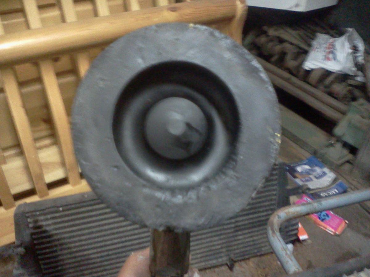

What type of air filter are you running? Does the turbo have any shaft play?
i'm using a stock one from napa. when i bought it it had a after market foam one. i dont know if it has any play. how do i check it?
Usually oil on the compressor wheel is caused by using oiled filters. Was the original foam one oiled? To check shaft play grab the nut on the intake side and try to lift up, down, in, and out. Also, inspect and see if the compressor wheel has been hitting the housing at all. If it is exceptionally loose your turbo probably needs some new bearings.

blow by  doesn't  go  through the  intake system.  Your  downstream oil  of the turbo (in the  cooler)  is  coming  from  the  turbo itself,   (seals are  bad)     I've  seen  extremely  plugged  air filters  that  would  make so much  vacuum, that it would  overcome the  seals  and   deposit  oil  into the  air stream... (but the  engine barely ran anyway).
A  lightly oiled   filter  won't put  that much  oil  in  the  cooler..
I've seen   terribly worn  valve  guides  put     oil  back into the  intake.   but  that was  on  naturally  aspirated   diesel.
I  vote  on the  turbo bearing and seal

I ran  K&N on mine for a while and thats exactly what mine looked like.

Mine was a little sticky rather than wet. I wiped a good bit of mine off with a rag soaked in brake cleaner. But the picture could be my turbo. I did not have the same residue in the pipe to the inter cooler, or if there was any i could not feel it. I did on several occasions re oil the filter without cleaning it while in the filter box. K&N recommended in the instructions I believe.
sorry i should of said it better . the oil is in the tube going to the cooler. i'll take some pics tomorrow to show you guys. i didn't get to work on it today. but will get it out this weekend so i can get it to the machine shop monday
That means oil is coming out of turbo seals. You need to put a kit in the turbo and the oil should stop!
thanks i'll do that while the engine is at the shop. do i need to clean the oil if any out of the  cooler too?
If you mean the intercooler, than yes you really should clean it out. If there is oil in it, there is a chance of it causing a run away engine. If it is just a little damp then I wouldnt really worry about it but if there is actual oil, needs cleaned. You wouldnt want a run away on your fresh rebuild.
I would still clean any oil residue from the intercooler so if there is any dust it doesn't collect inside the intercooler. It just best to clean everything from the turbo all the way to the manifold.

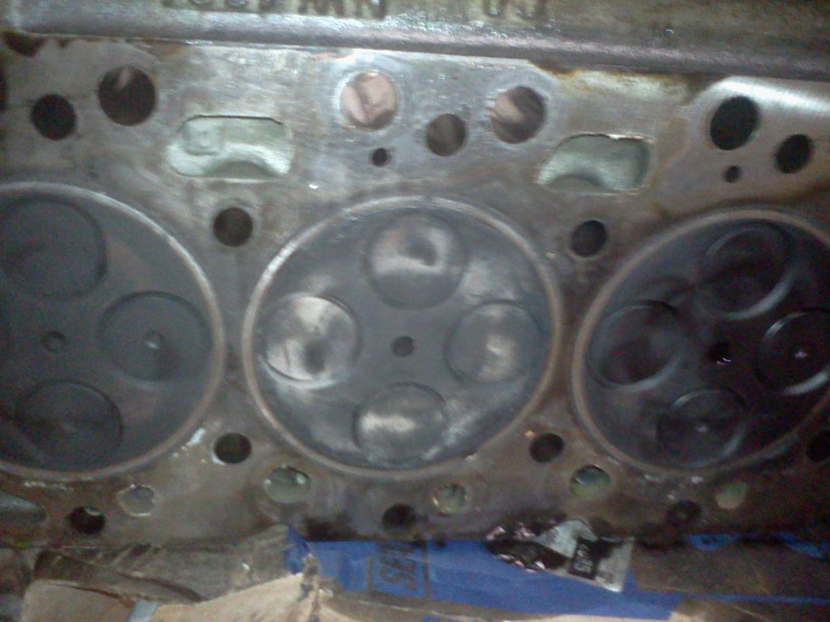

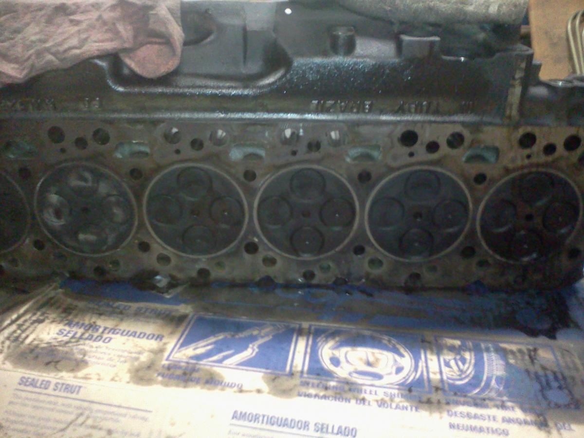

well i finally got the engine out. gonna call the machine shop tomorrow to see when i can bring it down and  ask if he wants me to tear it down before i bring it. i do want to take the head off to see the pistons. i wanted to ask you guys. my brother told me a trans shop told him to change his stock torque converter to a HD one on his dodge. that the stock one takes a dump. have you guys heard of this and if so what converter should i use. i don't want to have to separate the motor and trans again. also if this was your motor what rebuild kit would you use and is there any mods you would do to it. i only plan on pulling my car trailer, camping trailer, and dump trailer.
