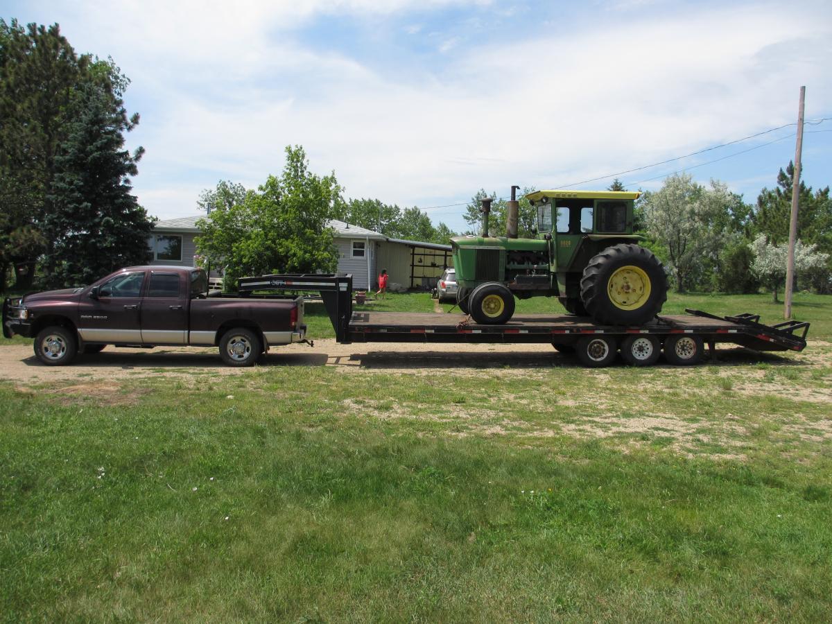

Just to give you an idea, my 05 has a 1.5" leveling kit and here is what it looks like without airbags and roughly 25K lbs on behind it. Hauled this JD 5020 with full wheel weight package 100 miles at 70-75 mph and it handled like a dream.
The 05 with the 1.5 levelling spacers and ranch hand bumper sits about 3/4 inch higher than stock height w/o RH bumper and spacers and still has a slight rake to the front when empty.
