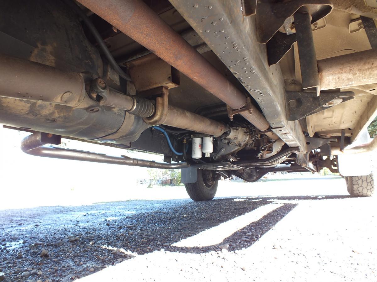

The "muffler replacement" is just a piece of exhaust pipe instead of a muffler. For clamps the system should come with all that you will need. However, they will be the U-bolt style clamps and I don't care for them much and recommend exhaust band clamps like the picture below, any heavy truck parts place should have them in stock. Off the top of my head I think it would use 5 clamps.

Ok I'll look for some of those style clamps, they look pretty solid. Is it reasonable to think a 4in clamp is what's used for a 4in exhauat or do you need to get bigger then what your trying to clamp?

You will need to use a few of the original clamps for the hangers.

Yes, you would use 4in. clamps.

Yep, Those or the preformed ones are the cats meow, most parts jobbers carry them or truck shops, easy seal is the brand name but there are others I have seen.
