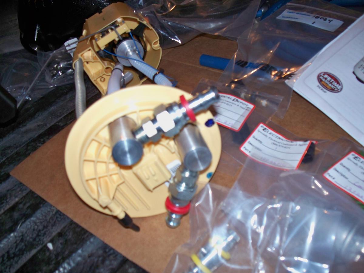

I installed a modified Liberty module from Vulcan with the 1/2 suction and return line.  I do have a FASS 150 and it was suggested to have the high flow return so as to not create back pressure in the return line.  It is a complete drop in unit.  Kind of expensive but in my opinion worth It.  I know Genos garage sells a kit to fix the sending unit but I do not know about the screen.
post-1146-0-76982600-1433553365_thumb.jppost-1146-0-97264500-1433553429_thumb.jp
