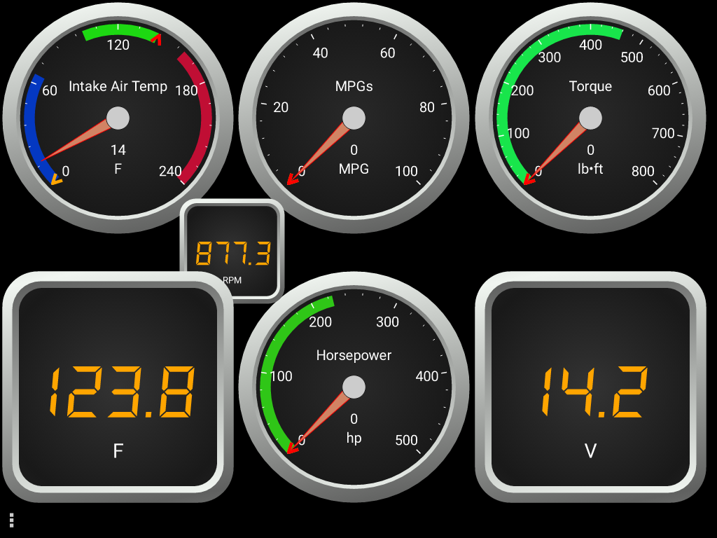

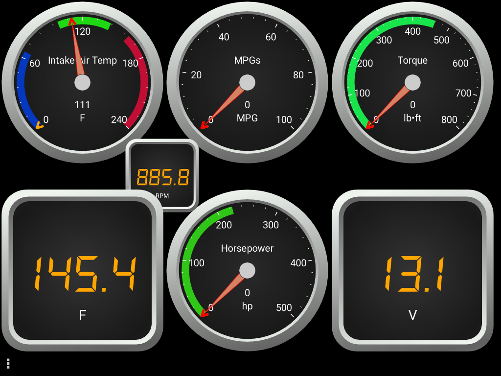

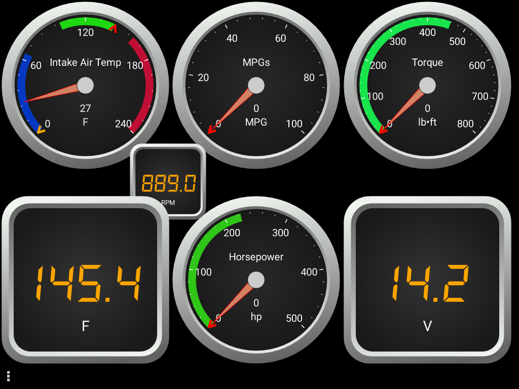

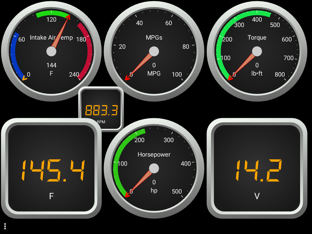

OK here's screen shots from different types switch positions
Truck had been running already for a littless
Here's it in what I thought was OFF
Here's it in what I thought was 6cyl
Here's it in what I thought was 3cyl
Here's it in what I thought was MPGS mode
What do you guys think?
Is bottom left coolant?

So your numbers look right but your placement seems off.
The switch position from left to right is
off |  MPG | 6 cyl | 3 cyl.
Can you put those images in order of notchs when you turn the switch clockwise?
Once you verify image location vs switch position we will get you fixed up.  Thanks!
Ok so the images are in order from starting fully counter clockwise then each click clockwise. So I just labeled the images wrong but they are in the correct order.
I guess my follow on question then is if the numbers are right and I'm seeing an insanely long delay in my WTS light going out, something must've changed ECM side then right?
so you are trying to start the truck in the mpg mode?  first click clock wise?  If so I don't see why the ecm would be letting hte WTS run so long.  If you had it in the 3rd or 4th position it makes sense, but not the 1st or 2nd posiiton
I am still confused about the last position now that I look at it.  It looks like the ect is swapped.    If you are willing ot ship it back to us we will test it and get it fixed if there is an issue.
Yea so that sounds like what was happening. I got the switch positions backwards and thought the MPG mode was the very last turn to the right. So that explains the long WTS. If you think something might be off I can send it back to ya. I just took it out of my 99 because I was going to put it in the 02.
It looks like the ECT for 3 cly is mixed up with 6 cyl.  I am more than happy to fix it for you.  You can run it how it is and not worry though.  If you ship it to me ASAP so I get it before Friday I will have it fixed and back to you right away.  After Friday I am gone for a few weeks so it would have to wait.
