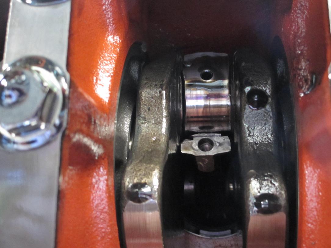

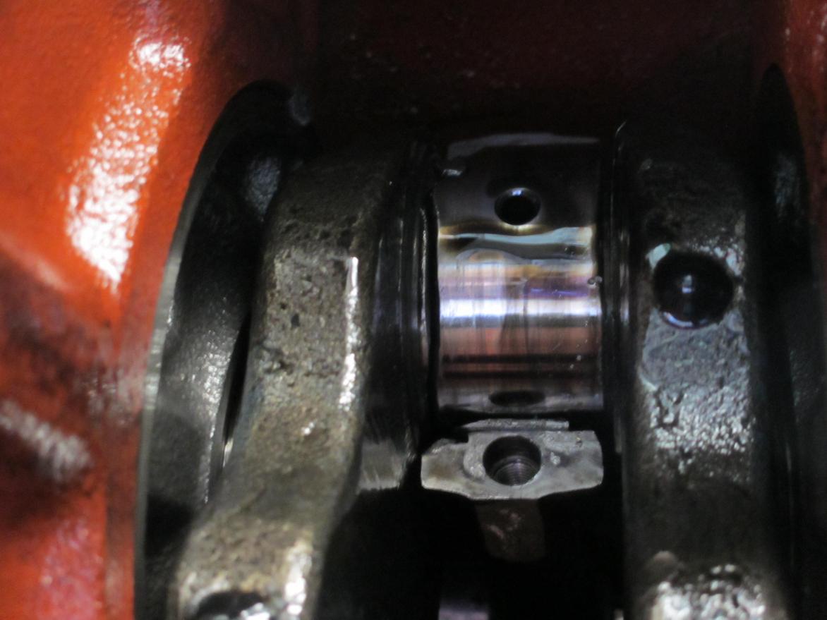

Dropped the oil pan and found the crank shaft broke on the front edge of the #2 rod journal, the rod cap was the only thing holding it together, answers the question as to why the front crank seal hemorrhaging oil during only a few seconds of craning it over now too. Now to start pricing things out knowing what I am looking for.
Here is some eye candy of the carnage I know everyone wants to see.
Upload failed on more pics will try again.
Have several pics of the crank but upload fails on all of them.:think:
Crank shaft is broke into 2 pieces if you look at the left side of rod journal in the pics you can see the clean break opened up a bit. That is the front side of #2 cylinder rod journal. I also found an undamaged spring clip laying in the oil pan at this point assuming it to be a piston pin retainer.
Found a guy in ID who may have a good fresh overhauled long block with a possible bad head he may scrap. Found good used cranks for 450 and reman cranks for 575 so far. Looking like I can be in the 2k range for my own overhaul if things keep looking this way depending on the price of the long block, he is going to do some checking and let me know in the near future.

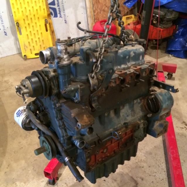

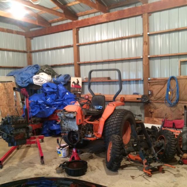

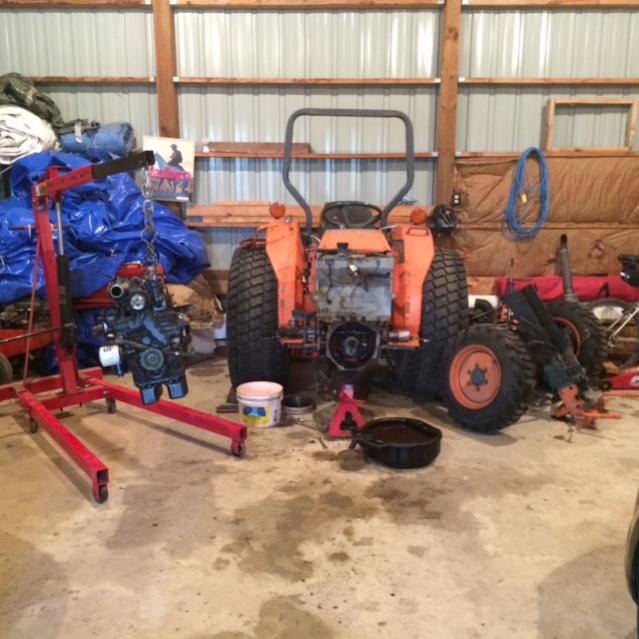

Well finally got around to getting started on the engine project on the hunk. Pushed it into the shop and got the engine on the ground in about 6 hours time, had the loader and front driveline off prior when I pulled the oil pan to inspect the cause of the knock right after I got it so that saved me a couple hours.
Hopefully next weekend I can get the engine torn down to see if it will be worth rebuilding for a reasonable price or if a reman engine will take its place. I can buy a reman engine for around 3200 with a year warranty. I am looking at parts alone to rebuild @ around $1800  roughing it rebuild kit is about a thousand new crank 550 used crank would be 450 not sure on a price for a new rod plus all hoses and misc stuff one runs into plus whatever machine work will need to be done. I am thinking it will be so close that a reman will be the way to go but will make that decision when I see the inards of this one.
I have leads and feelers out there to do a swap to a bigger displacement engine as well. The current engine is a 1.7L V1702 DI and the 2.2 L engine V2203 DI is a direct bolt in according to the Kubota Gurus and will gain me about 15 HP as well which this series tractor is good for anyhow.
Edited by Wild and Free

Anyone have more jack stands in use than this?
Only 2 needed one in front and one under the drawbar in back on mine but he spilt the center section out of his tractor so he needs to support the rear of the engine and the rear section, there is not much tractor to support here. I did put chocks front and back of the rear tires though so it can't roll or get bumped off the stands.
I got 6 sitting on shelf in my shop. Does that count?

Well finding a good used engine wound up being a lot longer ordeal than I thought it was going to be, between guys i was dealing with being wishy washy and or not getting back to me and tons and tons of engines out there out of refer units with way over 10K hours on them which i didn't want to spend near 2K on an engine that was near a $1500-2K  overhaul at which point I could have bought rebuilt engines for less. I finally found a supplier who had a lead on a low hour refer engine "supposedly" in the 3K hour range out of a wrecked truck and his price was really fair in comparison to most I found, getting shipped out tomorrow for a price of $1970 with shipping costs included.
It is a 2005 model engine "Which is 15+ years newer than the tractor" and is a newer style V2203 Direct injection and is 4 HP more then the engine I took out 34 jumping to 38 hp which doesn't sound like much but is actually a lot when dealing with these small tractors.I am replacing a 1.7L engine with a 2.2l engine but externally they are exactly identical and a direct bolt in unit. Hoping to have it by end of next week.
I am going to do a valve adjustment on it and have to swap the oil pan from my old engine over to it as it is designed for the front driveshaft of the tractor to clear and at that point will pull a main and rod cap to inspect the bearings just to make sure i am not wasting time installing the engine that needs work right away.
