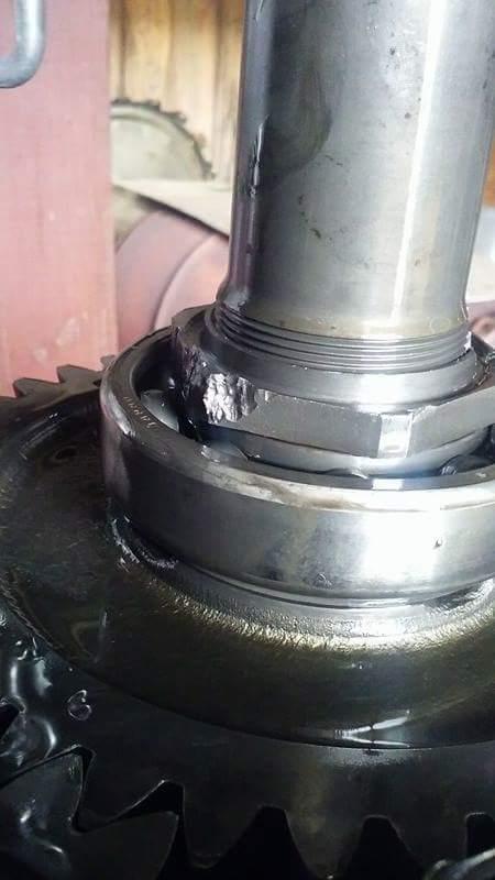

Nv5600 becareful who you let build

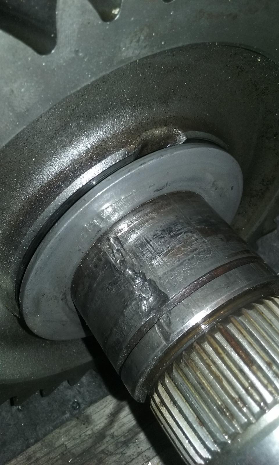

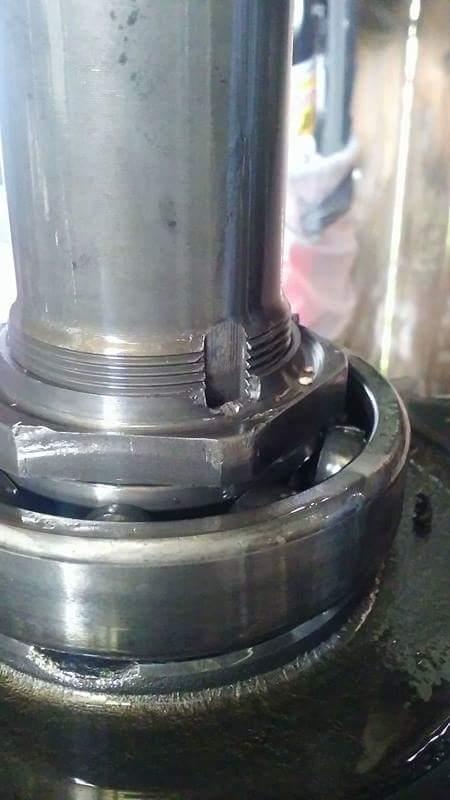

Becareful who you let build your nv5600 sence mine failed I've manage to get it pulled out, had metal in the oil, pulled the tail housing and found that unit was built with worn out parts, the main shaft nut was put on with a chisel and almost broked and not tight, this unit came from cummins performance parts i got took dont let this happen to you

I understand that you are tired of fighting it, but you aren't really fighting the trans just crappy workmanship sadly.
You really arent any safer with a nv4500 when it comes to quality of the rebuild.

Now also due to the dumb asses  that designed the trans I have to replace one of the counter gears cause it chipped during pressing the innessarly over tight gears

I've towed may times over 10,000 pounds of cargo (excluding the trailer weight). Fact is the two upper gears you use the most are on a 6 speed are the exact same gear on a 5 speed. Nothing gained and 5 speeds are cheaper to rebuild and no 5th gear nut is not a problem as long as the nut is properly torqued. IIRC the torque for the 5th gear nut is like 600 ft/lbs. So all these redneck youtube video beat the nut on with a hammer and chisel are going to fail anyways. Yes it's going to cost in tools to be able to do it properly but in the end the transmission is very strong.
