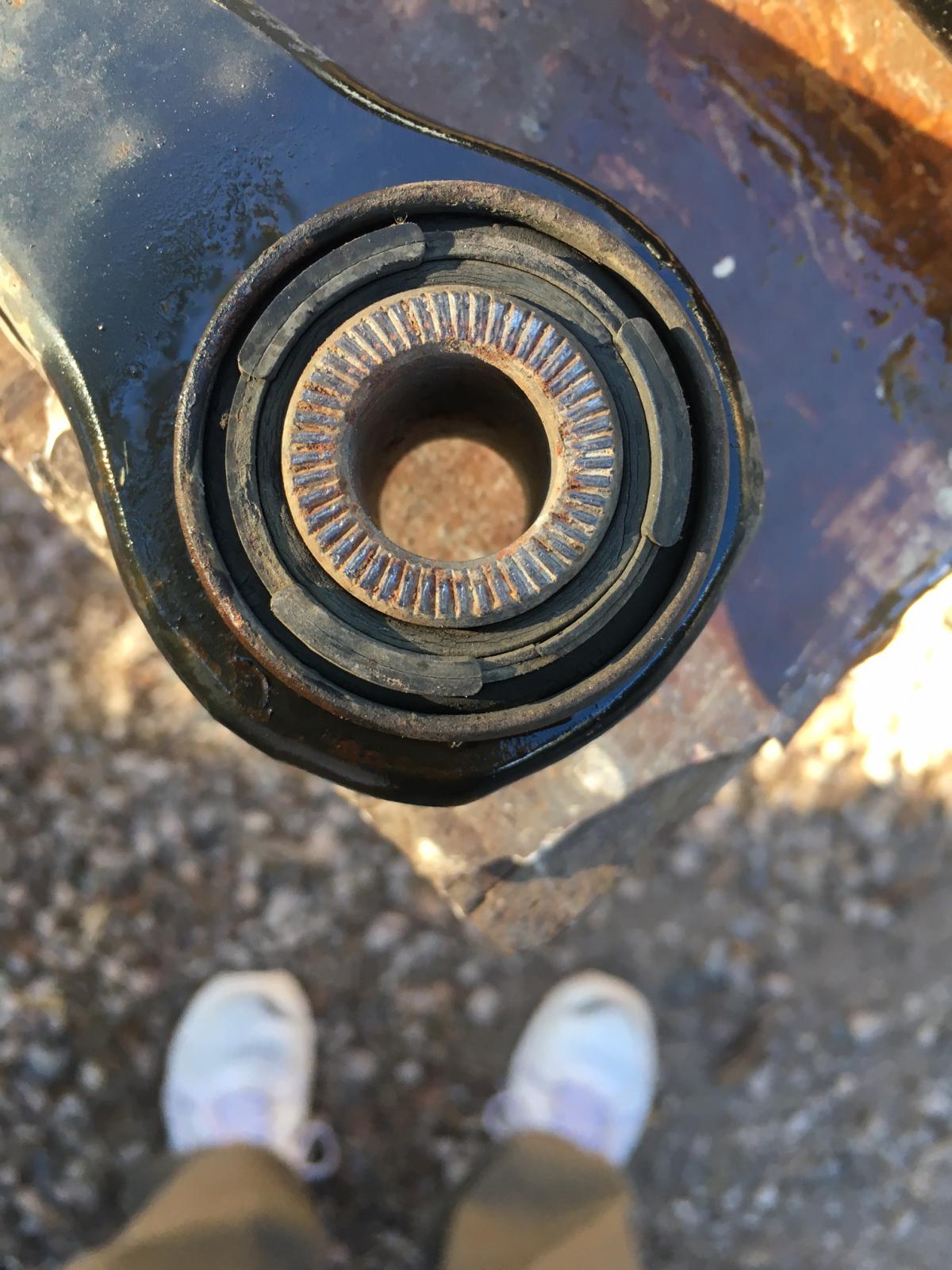

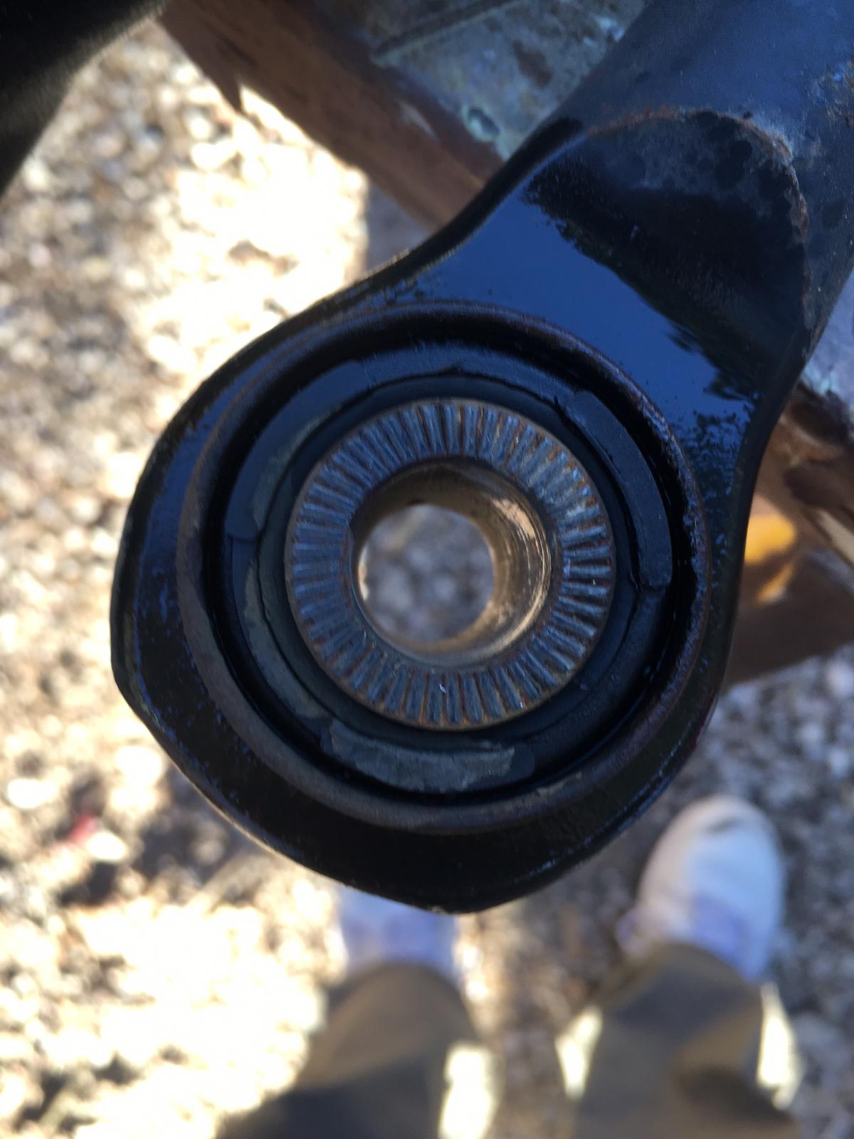

What about control arm bushings?
I would think the softer Thuren coils would help, but the steeper control arm angle will hurt you. When I went from a 2" level down to a 1" level the ride difference was night and day. Literally like going from riding empty with 80 psi in the airbags to 5 psi.

have not looked at body mounts yet.
control arms are next on the list to replace. but there is no slop in them now, so i'm unsure changing them out would change much.
