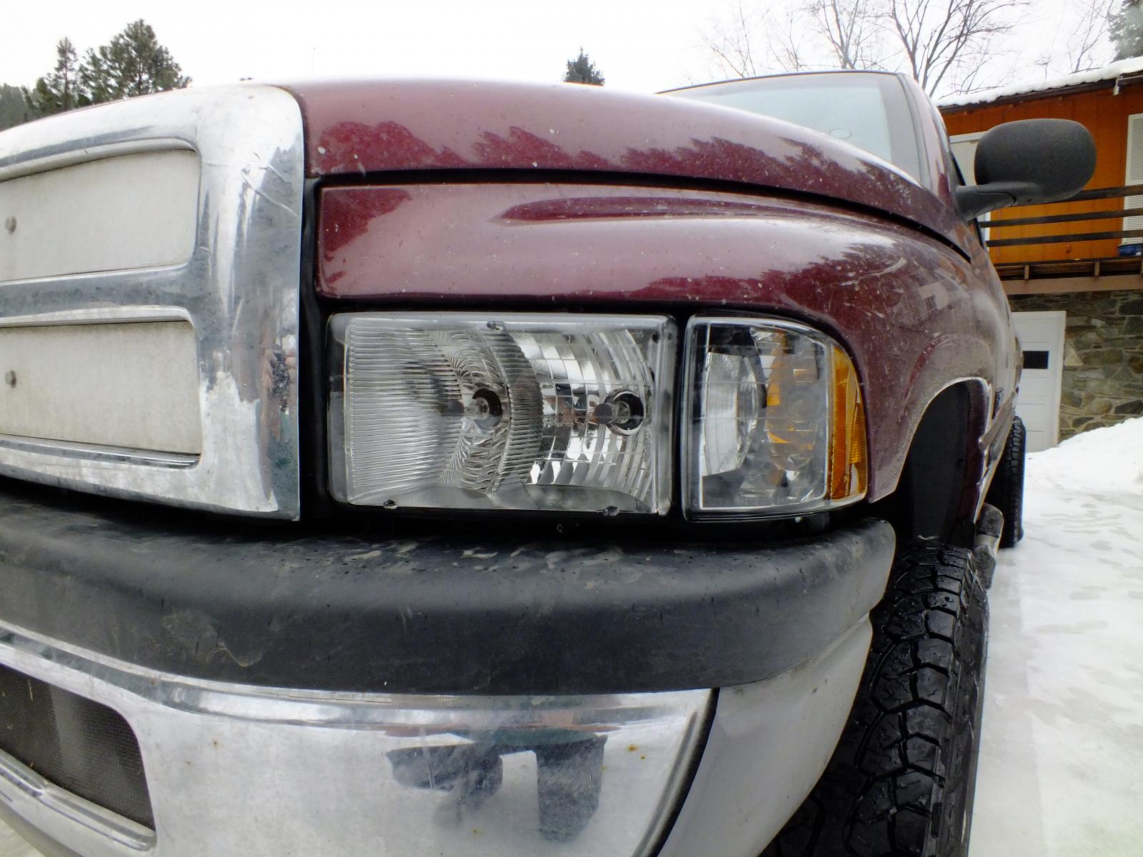

Don't bother with sport headlights. Britebox won't do much either. I've already done the sport headlights with relay mods and had all 4 bulbs burning. The path of light is still too narrow and not very bright. Halogen bulbs are big power consumers. Sad part is I ended up replacing the sport headlights in less than 1 year.
I highly suggest you just look toward the Morimoto HID's. I know the cost more but you'll be much much happier. Surprising how a 35w HID bulb is way brighter than four 60-watt halogen bulbs burning in sport headlights.

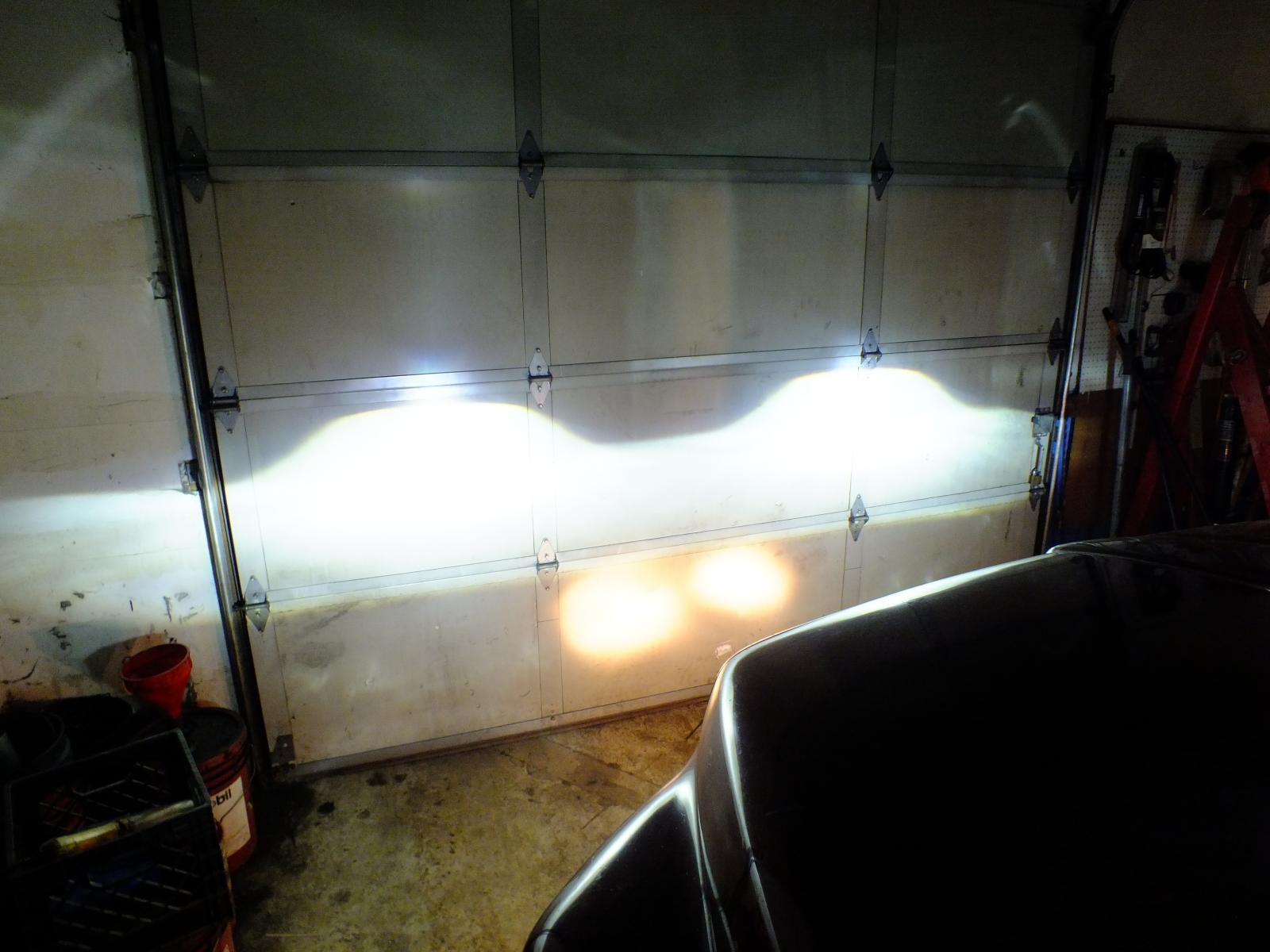

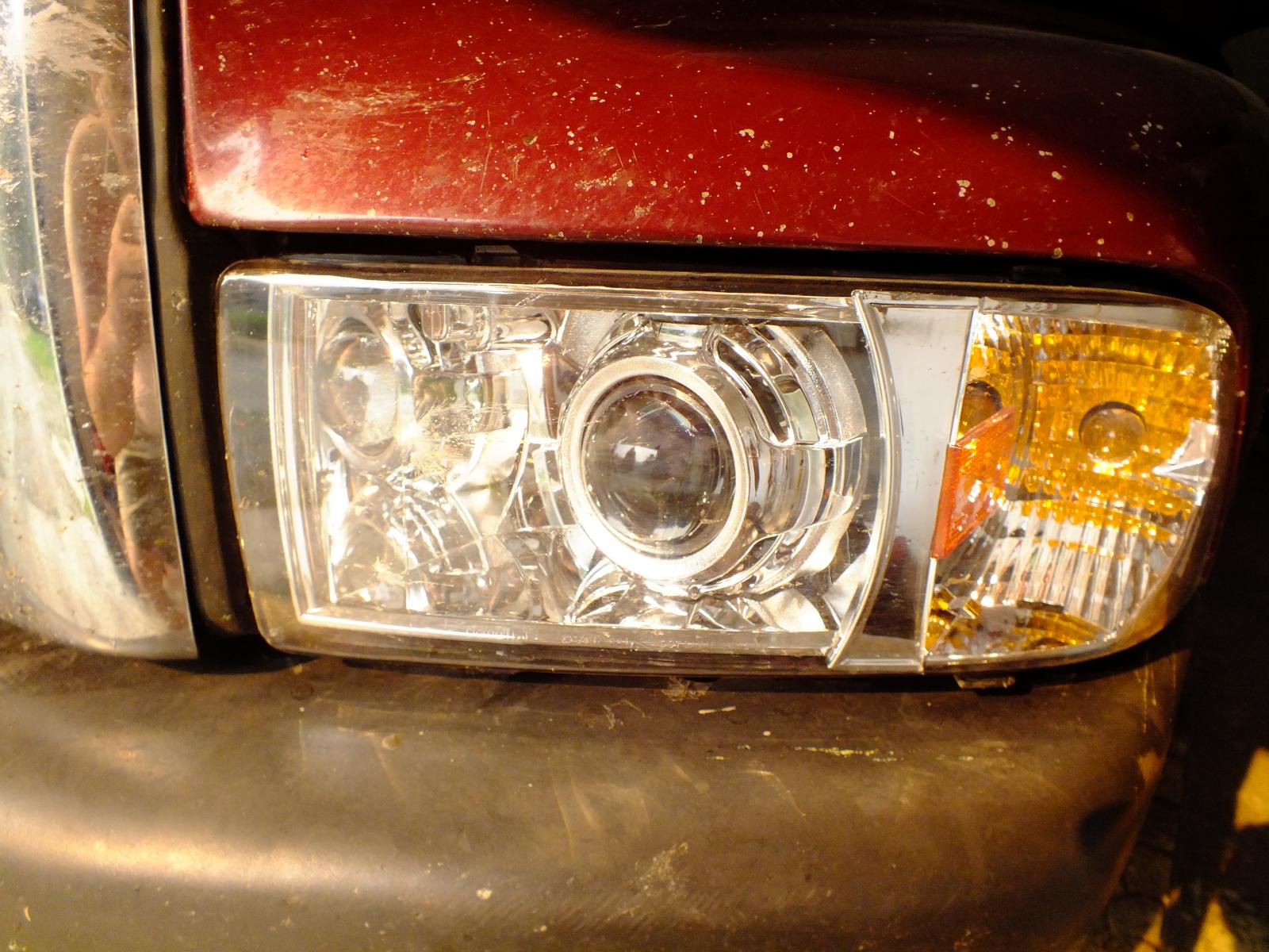

Extremely happy... My Morimoto are street legal. Very precise cutoff of light on low beams. High beams the path is huge I've got at least 50 feet into the ditch on the driverside on flat ground. There is a difference @Me78569@jlbayes and a few others did the H1 Mini Morimoto's. I'm doing the D2S Morimoto's which is a much bigger lens and seems to have more light.

Retro Shop sold me the full kit. All wiring and 2 assembled headlights. They are even tested and aimed for you. Just bolt them on and plug them in that all. Really simple to do. All ballast, relays and wiring supplied.

I built my own as I wanted a simple set with no frills. They are extremely easy to do as well as setup. On cf you were likely told no pnp lights, if they said no hids period shame on them. Also on the smoked lens deal....you want more light output, not reduced. The smoked lenses do just that. A clear lens is what you are after. Mikes lights were a complete drop in and go. Make the harness connections and that would be it. The components are not inexpensive, https://www.theretrofitsource.com is where I got the projectors. You can check cost there if you'd like.
