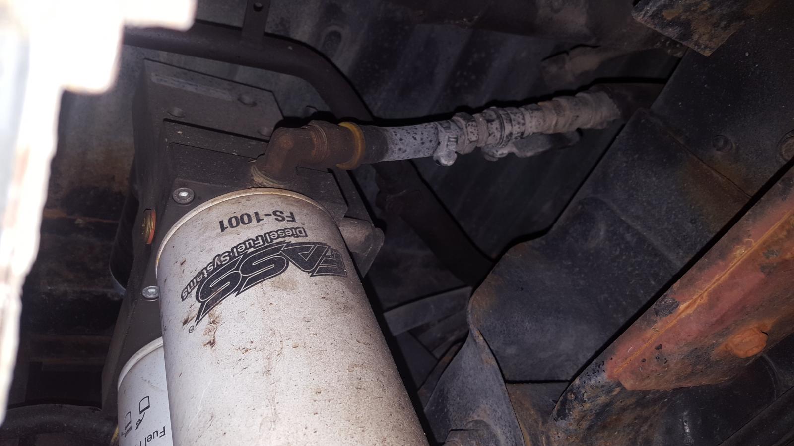

  • So you don’t like the setup or the size?    Ive had zero issues with road debri and can’t speak much on gelling as I’m not in as cold a climate.    Either way, mounted in that gene
Long Bed. Forward most bed mount. Used draw straw 1 in factory module. All fuel line covered with convoluted tubing (wire loom) and zip tied to wiring harness that runs along the frame.
Gipper,  I see you didnt run their 90 degree fitting on the pump at suction port. That was one of my concerns
If you’re worried about the 90s restricting flow you could always get other fittings from Vulcan or somethin. I have one 90 on my long bed. I think it just made the most sense to use it due to how I wanted to run my hosing but it’s been a while now since I’ve done it. Either way you’ll be fine.

Took me a minute to figure how you have that mounted. On the second bed bracket back and pump attached going forward toward the cab. Good Idea. Good photo angle, Looks Good
Got any other pics of how your other hoses are run? I dont see the return line

Thanks bud, that was on a clean install though so everything looks extra clean haha!
Sure I’ll take some from the front to show the return. Give me a day or two but mainly I just wanted to route the hoses up and over the frame as soon as possible so they’d be left exaposed as little as possible to anything that could get stuck up in there.

Here’s another pic. Sorry it took so long.
I get this isn’t the most ideal spot due to road debris, but I think it’s fine for anyone not doing the majority of driving off road. Otherwise I’d fab up a shield and call it a day.
