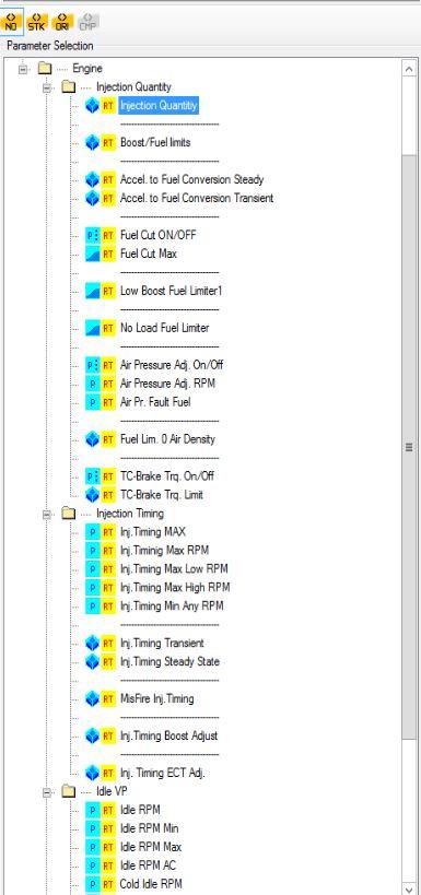

@Mopar1973Man  is datalogging actually on vp trucks?  the verbage they use is not clear.
Here are the PID's they list for the vp trucks.  I would guess, if the datalogging works, that you get these?  again our trucks are old.
The learning curve shouldn't be that difficult.  I haven't looked at the software yet, but so long as the necessary tables are available in the software than just about anything is possible.  I have a lot of history tuning OEM computers, standalone computers, and piggy back tuners.

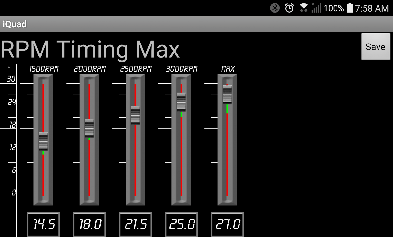

The Quadzilla doesn't do anything to the OEM tables.   It alters the fueling command of the ecm based on user input for eash psi of boost.  So you get hte resolution of the oem map, with a multiplier to add or pull fuel.
for timing it takes calculations based on current conditions/ sensors vs what the user wants at given points then outputs on a sort of linear on the fly "map"   no real maps, all calculations.
So fueling resolution is the same as oem, timing resolution is greater than oem.

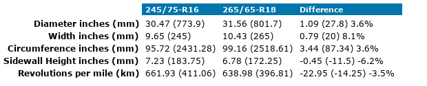

Huge improvement to acceleration dropping from 31" tires down to 30" tires which now give me the final ratio of about 3.69 to 1 to the ground. I'm so quick now I'm whipping 4th gen on the city streets. I'm liking the 245/75 R16 profile and plan on switch the 1996 Dodge over to 215/85 R16 which is the same 30 inch tire but 8 inch wide face.
25 minutes ago, Mopar1973Man said:
You might read over my tire find...
I have 4.10 gears and you have the 3.55's according to your article.
Stock tires are 245/75 R16
Currently running 265/65 R18
