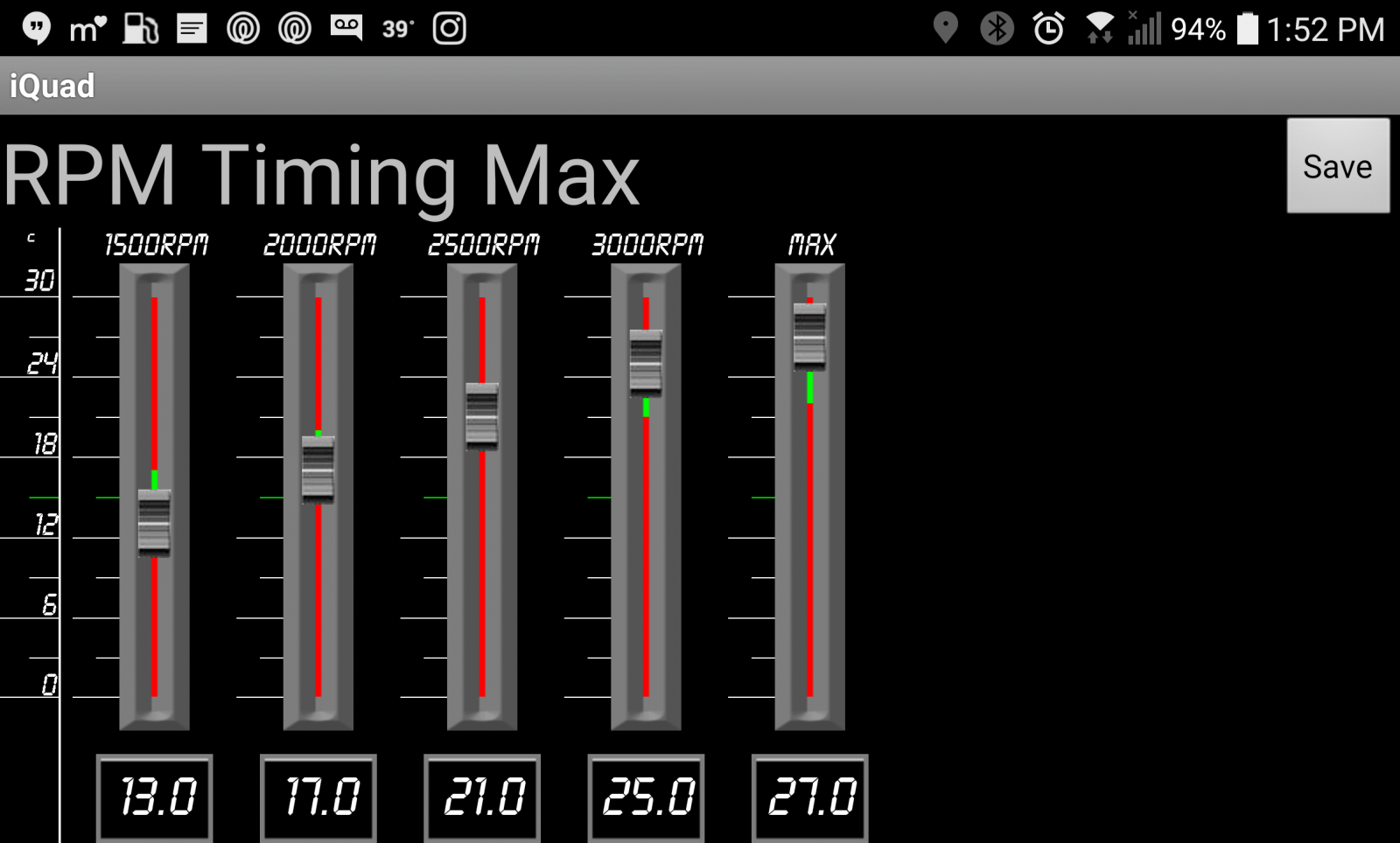

I was cranking up the timing and advancing heavily because of the old injectors creating large droplets. Now larger the droplets the longer it needs to heat to vapor and go BANG.
Now with the fresh injectors at 320 bar now the droplets are very fine and small. The cylinder temperature is enough to make it go BANG in a very short time. Now if I left my old tune running at 22* at 2,000 RPM it would rattle fairly well and that is negative torque building up. Start backing down the timing and the rattle fades back and get quieter. Now watch for the engine load to drop down which is sign of optimal timing because you need less fuel if you hit the sweet spot.
Remember Quadzilla drops it tuning and reverts to stock ECM below 1,200 RPM. Where Smarty S-03 reprograms the entire ECM from idle up. Then Smarty you can't see your timing in real time to make educated adjustments to timing. Still have no idea of the span of timing on Smarty S-03 tune.
Previously timing...
16, 19.3, 23.4, 27.1
Insight to what I got.

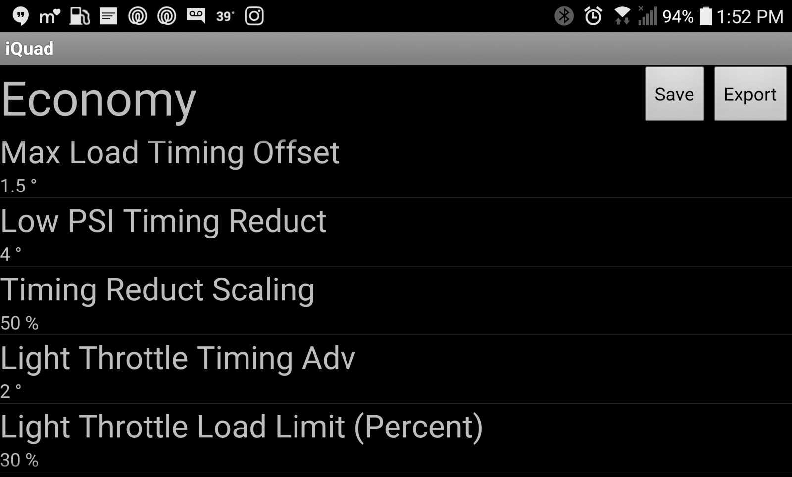

Nothing really changed here. Light Throttle Timing was up to +3*.
