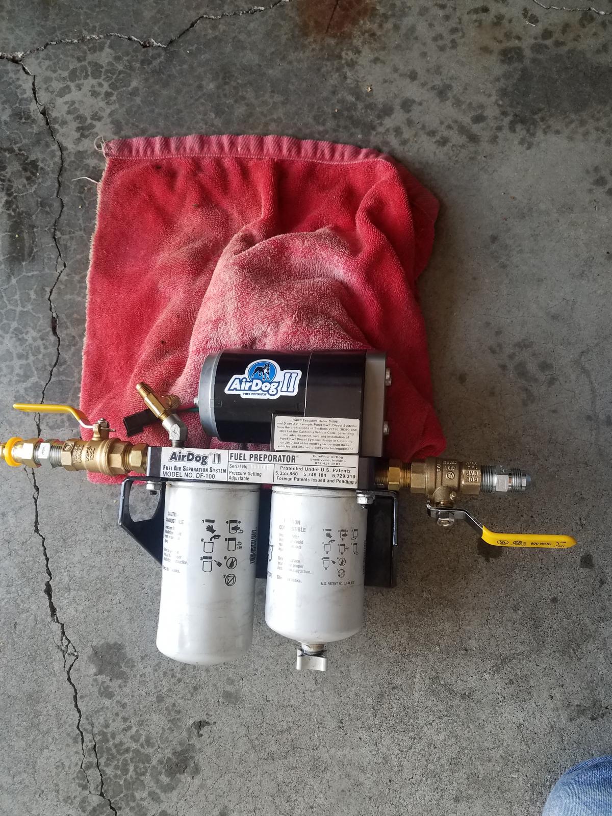

  • I care..  i don't know if it's been talked about or not but what i found be really handy is shut off valves before and after fass pump.  Changing filters,  priming Etc   I'm did the fass pum
