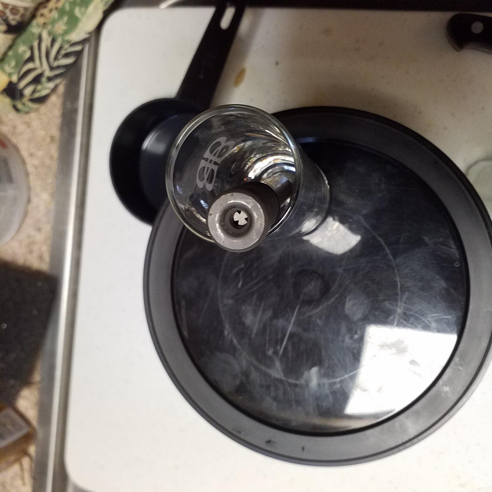

So I've been doing research lately, and had a sneaking suspicion that I had a leak somewhere after my injection pump. After looking hard, sure enough #5 fuel line was slightly wet. I said screw it and ordered an injection seal kit from thoroughbred (I think), and while I was at it I broke all the injectors down, soaked them in naptha, cleaned them more with b12 chemtool, then reassembled according to spec.
With the new washers on, I've popped all them in by hand, set the crossover tubes in by hand, and now I'm about to torque the injector hold down clamps. The injectors are sitting higher than normal, is that normal? I figure the new copper washers haven't been seated yet, so they're up a bit higher, but is it OK to crank down those tiny 8mm bolts to seat them?

I didn't get it started today, as I ran out of daylight. But Dieselfuture pointed out my torque values were wrong on the nozzles, and they're way too tight. I'm going to yank them tomorrow and tear them down again. Hopefully I didnt screw anything up....

I don't, I wish I did know someone. It seems like theres a ton of air in it still. It takes forever to start, and just pours white smoke when I rev it. I cracked lines 1,3,4,and 5,and they were spraying ok. I didn't get 2 because the air horn and grid heater were in the way, and six was blocked by the lift bracket. Can I take it off and just put the bolts back in? And can I run the truck without the grid heater and air horn on? I could get all the injectors then.

1, 3, 4 and 5 with good fuel to them should start the engine just fine. It will idle rough until all the air is out but it should run. You can run it with the intake horn off no problem. I had to hunt my lifting bracket up. Took it off 8 or 9 years ago while replacing my oe injectors. The only time you really need it is for removing the head. I did not put the bolts back in the block but cannot see them being there an issue.

Crossover tubes, per dynamite diesel instructions, then injectors. I also held my finger on the tubes and spun the injectors a bit to make sure they were seated.

I will once I get a stock set. Also I'm going to try and bleed all six injectors while it's running and see if that helps. I also noticed my fp gauge was bouncing while the truck was running. I think I might have to bleed the injection pump more. All in all it just acts like there's still a ton of air in it.

Got the new injectors from WiscoRedkneck, and they worked like a charm. Truck runs alot better also. Down on power obviously because of stock injectors, but it drives much, much smoother. Also starting is a dream, I barely hit the key and it lights off. Hasn't sputtered much either, just small amounts. I'm starting to think the old 150s were going out in it and it wasn't running like it should have.
