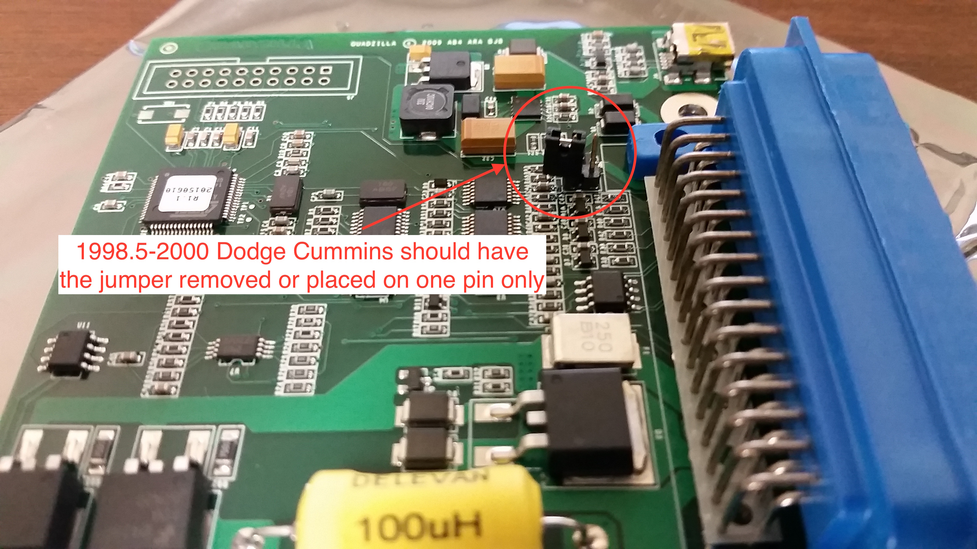

Check the map setting inside the box for a late year truck
1998.5-2000-adrenaline-jumper-placement.

I went ahead and checked that pin on inside of the quadzilla and it was correct.
