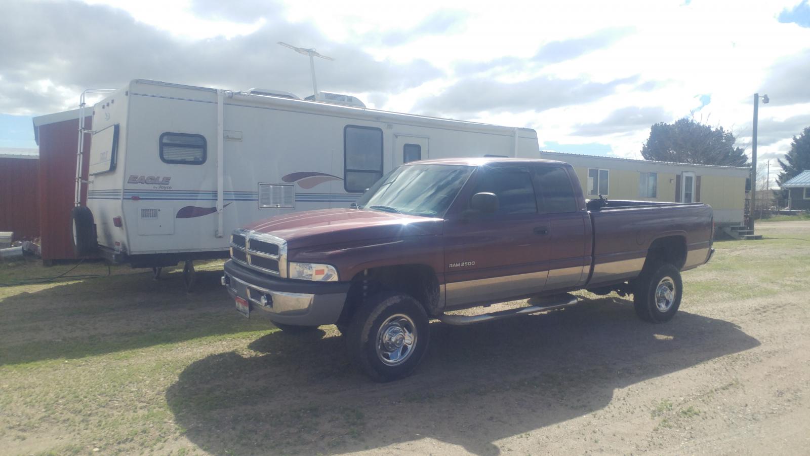

I own a 1998.5 24V 2500 long bed extra cab, with canopy. Pretty well stock powertrain.  I installed a new HX35W turbo a couple of months ago. Currently running a Herko fuel lift pump that gives me18 psi at idle. Maintains 10 psi pulling a decent load up a hill. Today I installed an A-pillar gauge package. So far boost, lift pump pressure, and exhaust temp gauges are functioning. The transmission temp gauge, I'll hook up later.
This January we purchased a 23 ft RV trailer. We've been getting it ready for camping season. Empty weight of the trailer is 4,950 lbs. Dual 3500 lb axles under it. I just installed new tires on the trailer and upsized them to a higher weight rating. I installed a new heavy duty, square bar type equalizer hitch. It feels good, I feel safe on the hi-way. It tows nice.
What has me a little weary are a couple of things. The added gauges on the truck keep me well informed. So much so, maybe I was better off ignorant and clueless. LOL. It's a stock truck as mentioned. The truck never had exhaust pyros when new. How much concern should I have about exhaust temps with this truck? Under hard acceleration, unloaded I can get exhaust temp to about 1050-1100F.  I live up a mountain. The road home is pretty steep. It's a slower 2 lane winding road. Speed limit  30 mph. It's about 3.5 miles from the start, to my driveway. I gain about 1100 feet elevation over the 3.5 mile climb home.  Average road grade over the 3.5 miles is 10%. You cannot get a run at the hill. My 24V 5.9, to me feels like its working hard to tow my trailer up this hill.  Watching the exhaust temps, I backed off the throttle and maintained 950F to 1000F while climbing the hill home. I was at about 8-10 psi boost.  My speed was about 15-18 MPH. As mentioned this is all new to me as I prepare the trailer for camping season. The cooling system in the truck handled the climb well. Fuel lift pump pressure steady at 10 psi. Engine steady at about 1900 to 2100 RPM up the hill. I did not actually time the the climb up the hill, but doing the math its about 12-13 minutes up.
I feel like I am working the truck damn hard. There are no other hills around here that I know of like this. I suspect I can comfortably tow the trailer most anywhere except back up the hill home.
Towing with my Cummins today is new to me. Is this normal? The engines are pretty hearty it seems. Maybe I am just not used to hearing the engine grunt so hard. Should I be concerned or am I being too cautious. Just work the SOB, that's what it's deigned to do?
Your experience and comments are appreciated.
Here is the rig as driven today.
