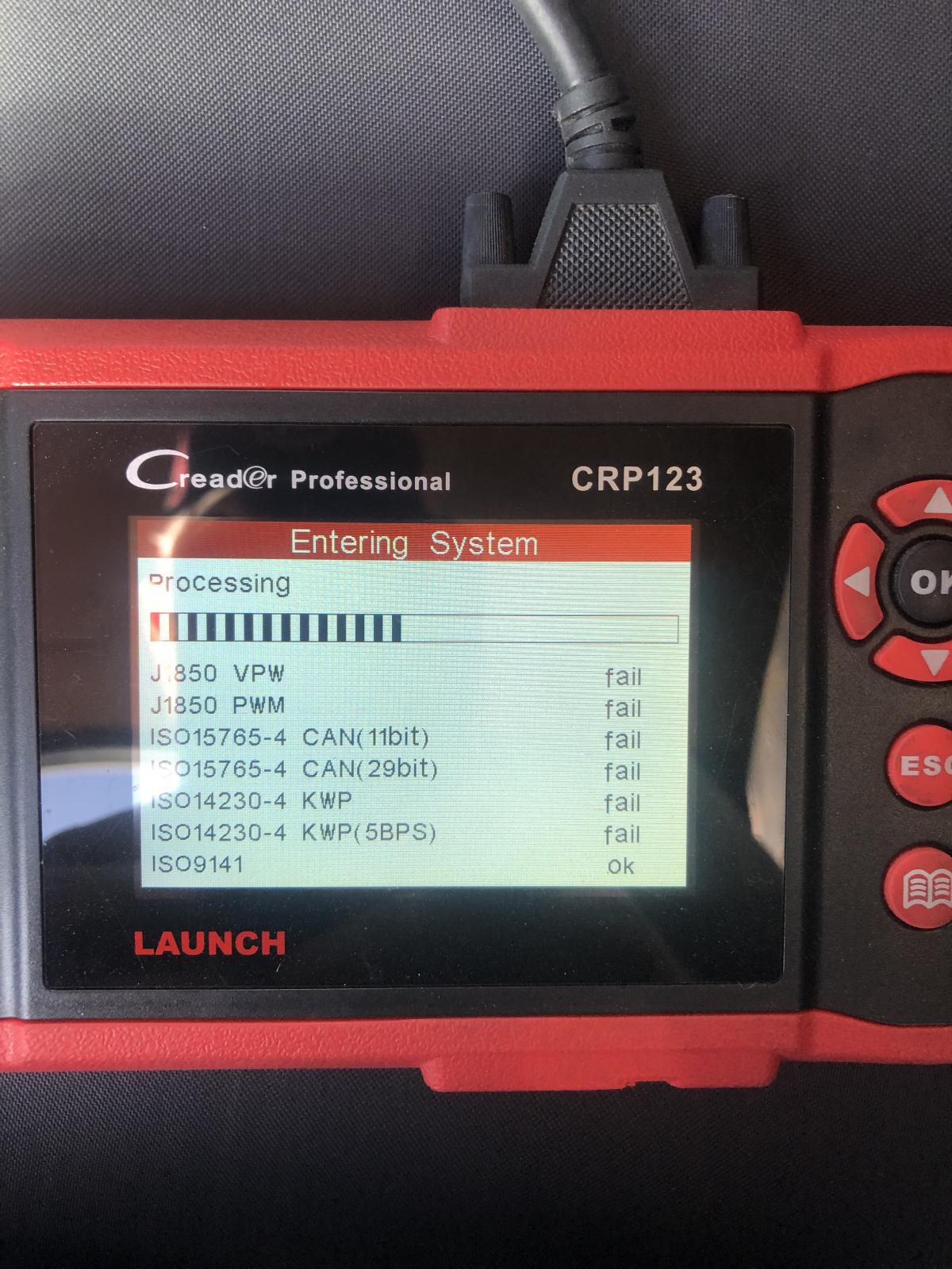

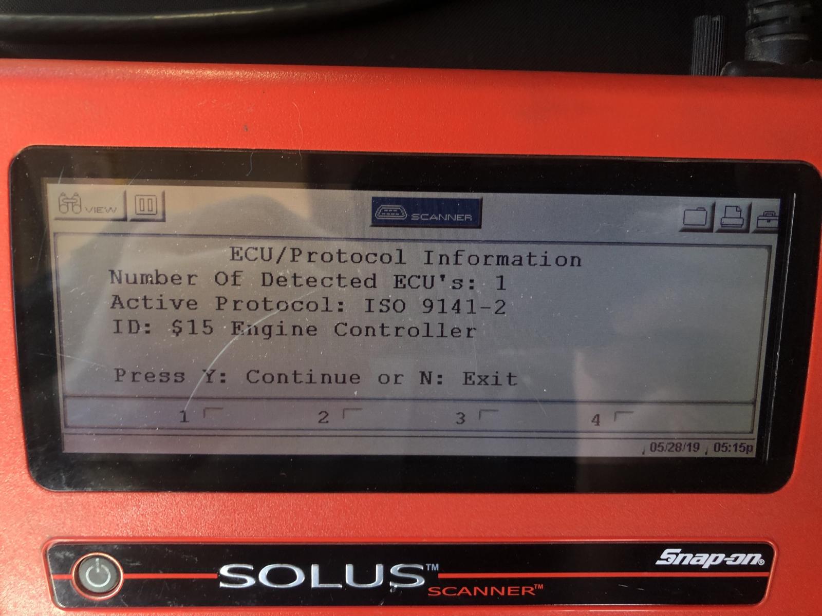

what bus are you reading when it losses communication?
I'd like to know this as well. Does a plain old cheapo OBD2 scanner lose connection, or is it the j1939 bus, etc.
I’ll go check in a second . What’s ironic is that my cheaper scanner shows me which data link it successfully connects to but my solus just tells me which key it’s using .
Ok I made the solus attempt a connect in a different way and it backed up the other one. Both are accessing the ISO9141. That’s not something I’ve ever heard of heavy duty trucks so it’s Spanish to me .
That's just the language the truck speaks.  A lot of the European car makers use it.  I have a CRP123, my Matco reader does a better job on the Ram trucks.
