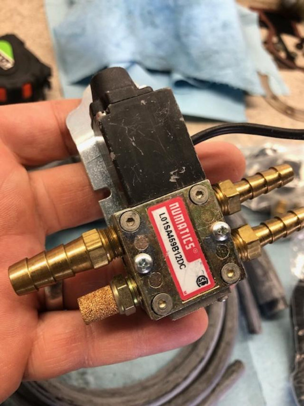

 Can you get a good clear up close pic of the vacuum solenoid please? Id like to see the numbers on that one.
 My brake works fine. The vacuum valve to jack up line pressure, not so much. I screwed something up and i think its in the valve body. Don't try it.  Haven't had time to check it out yet but i just ordered a Dynamic valve body the day before i hurt it  so I'll probably just park it until it gets here.
13 hours ago, Gregturley said:
@gimmie11s good score. Yes it will work but they changed the throttle switch from one that mounts underhood to one that mounts inside on the gas pedal. Im sure you could make it work easy enough because all it has to do is close the switch at idle and open it as soon as the throttle moves. Download the pdf that i linked. Its the updated instructions.
Thanks.. my truck is a manual so i wont mess withe line pressure deal...
Here you go

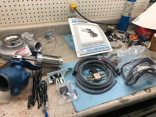

@Gregturley i found something interesting.  There is a warning label on my brake telling me this unit i have (part number C14000AT) is for automatic trans trucks only and that using it on a manual would harm the engine.  My truck is a manual so that got me wondering if the brake you have is for an auto or manual and is there really a difference?
Both of these brakes (yours and mine) are for 12v trucks with the weaker exhaust valve springs.  Fair enough.  My bigger question was what is the difference between the two brakes?
Looking at your pictures, ive found the answer.  You actually have a manual trans exhaust brake.  The orifice on your butterfly that is NOT plugged with a bolt/nut is 31/64" and much larger than the same orifice on my butterfly.
Both brakes have 2 holes drilled into the butterflys.  One of the 2 holes is a beveled hole that can be plugged with a nut/bolt (like yours) for more braking power once the theoretical 12v truck owner upgrades his exhaust valved springs.  The OTHER hole is specific to the manual trucks and the auto trucks.  The auto trucks have much smaller 2nd hole (around 1/4").  That manual versions have a much larger second hole of around 31/64" like yours.
Long story short, i should probably plug my 1st hole and drill out the second hole to match yours.
You should weld and re-drill your 2nd hole to a smaller size for better braking power.
Here are a couple pics
