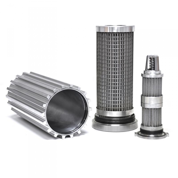

Now all the Cold Air Intake Filter every time you wash the filter it losing it micron rating. So how many washes till the filter is nothing more than a screen door? I know K & N is a screen right out of the box. For all you that like washable air filter here you go a Cummins washable oil filter. If you trust your washable air filter go for the washable oil filter and tell me all about how it short the engine life. I'll wait... :rolleyes:
Is that meant for a 1940's engine?!  Looks good for a prefilter.
That is for our 1998.5 to 2002 Cummins ISB racing performance oil filter.
