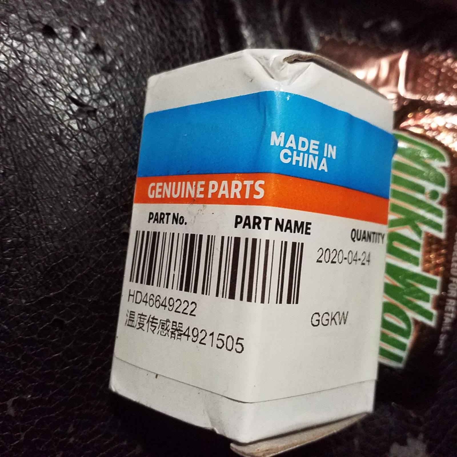

  • I think my truck just got insulted. I will go out and ask her later. I'll have you know she gets only the best genuine parts, as this label will attest to. I like the candy bars.

Well here I am 2 months later and the $15 sensor is still working fine. Maybe some hope for it.
10 hours ago, IBMobile said:
Where did you get it?   I'll buy one and through it under the seat for a spare.
Fridayparts.com. I can get a part # when I get back home. They offer several from $15 to $200 and alot of other sensors and such. It all appears Chinese.

The part number is on the box   HD46649222
