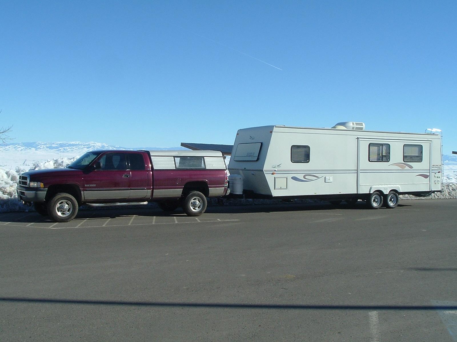

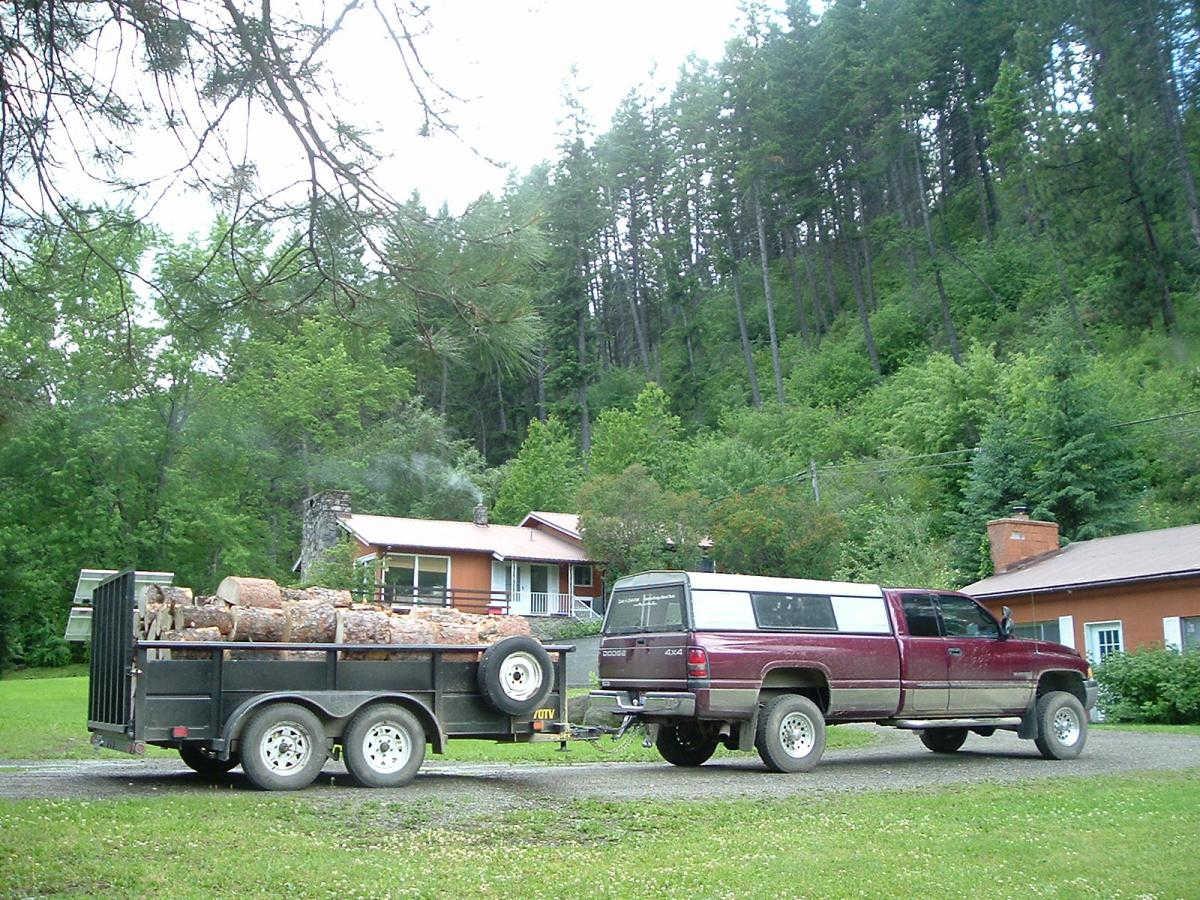

The whole thing behind the rake is so you can carry a load without your headlight shining in the sky because its swatting in the rear. Any leveling kit you put on the the rear will sag down when loaded. I've been up close to the 26,000 pound limit on my registration of my plates.
Here I am with GCW of ~17,300 pounds, and about 62 foot long total. Sitting level. (Nevada 2020)
Another... My truck is always level towing. No need for lift in the front.
Level hauling 2 cords of firewood...
