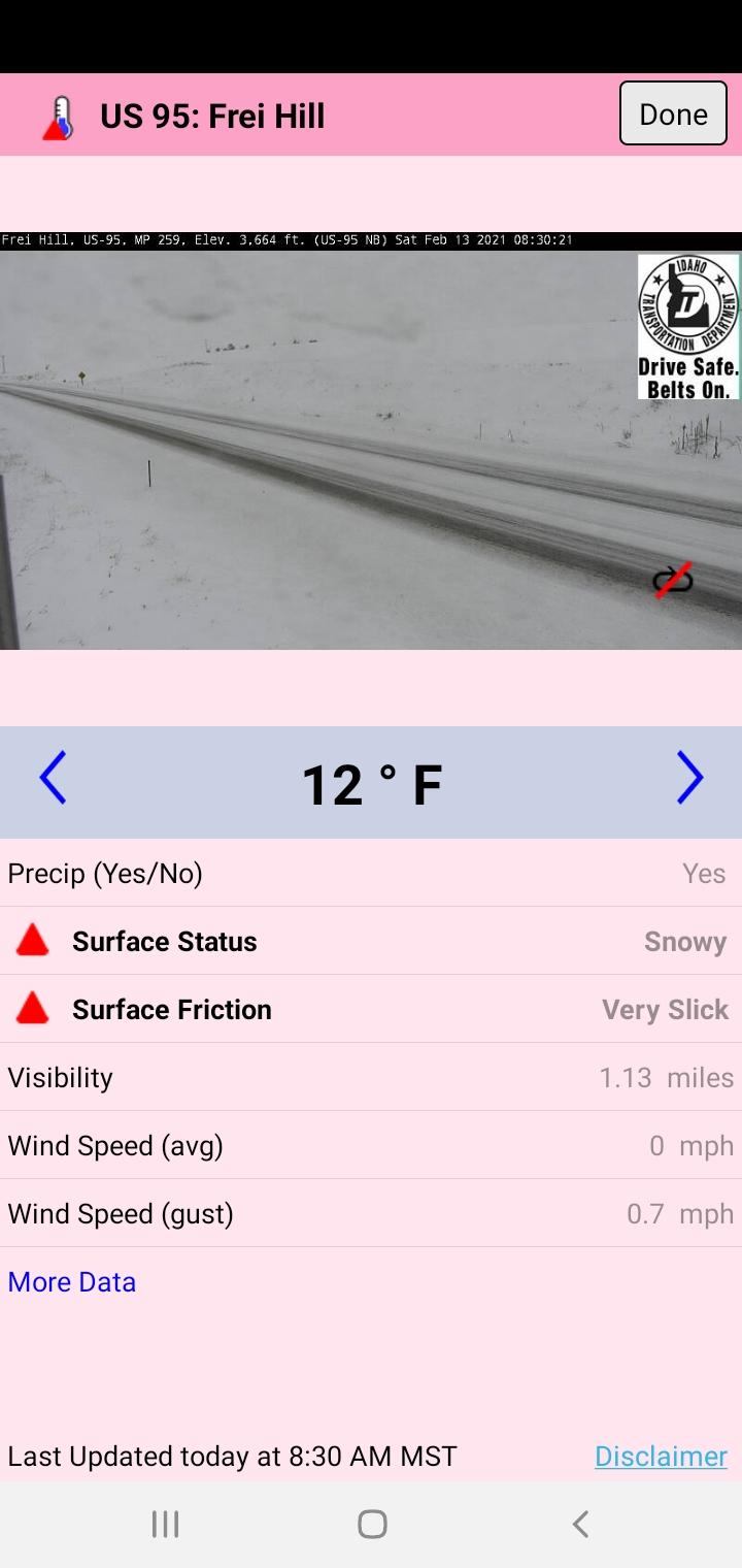

Now I'm heading to Lewiston ID.
I'm glad I'm not in northern MN!
Another morning about the same for me. Yesterday I went out cycled the grid heater twice fire up normally at +12*F no problem. Warmed up in about 5 minutes road travel shedding ice from the windshield. No block heater was plugged in.
