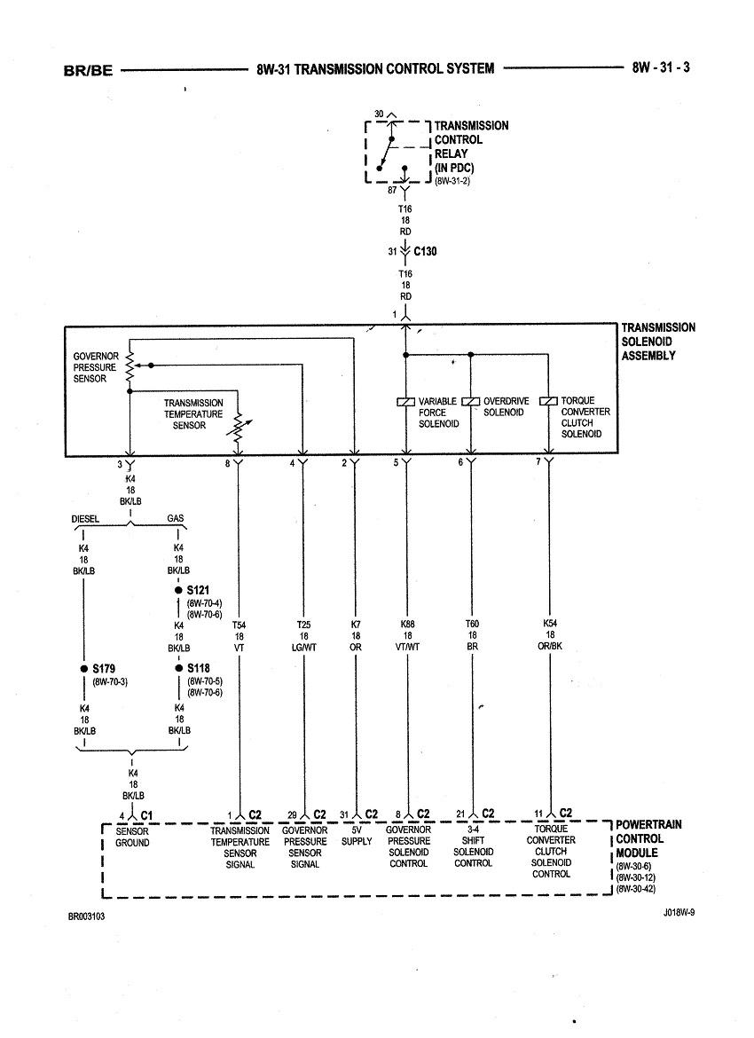

1999 dodge Cummins 2500  truck has 168k with a DDT tranny installed about 120k  miles ago . It has a smart controller installed to keep the torque converter locked up for the BD exhaust brake to slow me down while hauling my slide in camper . Third / forth gear lockup at 50 mph kicks out at 30 mph.  275 hp Rv injectors and edge  set on high about 300 hp. Tranny built for this much horsepower. This my set up.  10 amp fuse in PDF blows when key is turned on.  Has code p0753.  Relay is good  horn test.  And pin 21 on the PCM READS 33.3 OHMS. Pan has not been down yet.  I need good advice on what to do next ?

Ok late last night I had a couple thoughts go thru my brain on the up and coming transmission repair. Want to bounce it off you guys. After the fluid is drained and the pan down and the  parts replaced can I/ we test the  10 amp fuse in the power distribution center by turning the key on no start to see if it blows before we put the pan back up and add the new fluid . Also  I spent $250 on the two quality parts should I use the two new old school parts I have in my emergency jockey box as test dummies.  I would hate to compromise my new expensive parts to test a fuse. Then replace with the good ones. What do you think ?
When you have the pan off disconnect all the solenoids and transducer, turn key on.  If the fuse blows before any component is plugged in then there is a wire shorted to ground.   Now plug the old components back in one at a time and be sure their bodies are grounded.  When the fuse blows you'll know which component is bad.
Power to pin 30 of the transmission control relay comes from fuse I (20 amp) in the PDC
