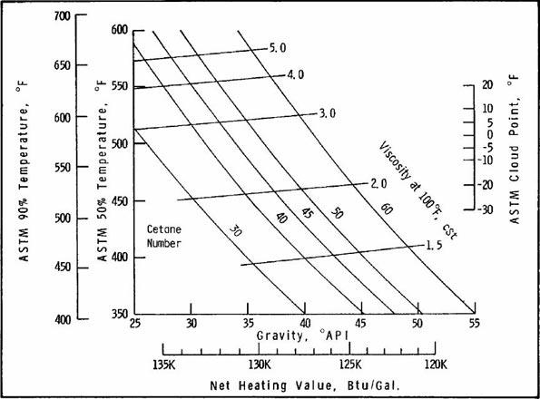

As you can see the highier you make the cetane the lower the BTU content becomes... So its best to have low cetane fuels for you truck. Even Dodge suggest 40 cetane in the summer and 45 cetane in the winter.

Posted Image
Posted Image
Posted Image
