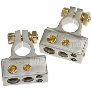

This is just my opinion, but back when I was a bass freak, I got battery clamps that allowed me to connect everything to it under the sun. I dunno how many accessories you have, but it may be worth to get them now instead of something else. I know I'll probably get them some day when I have too many accessories or they wear out on me.
They're along these lines:
Posted Image
