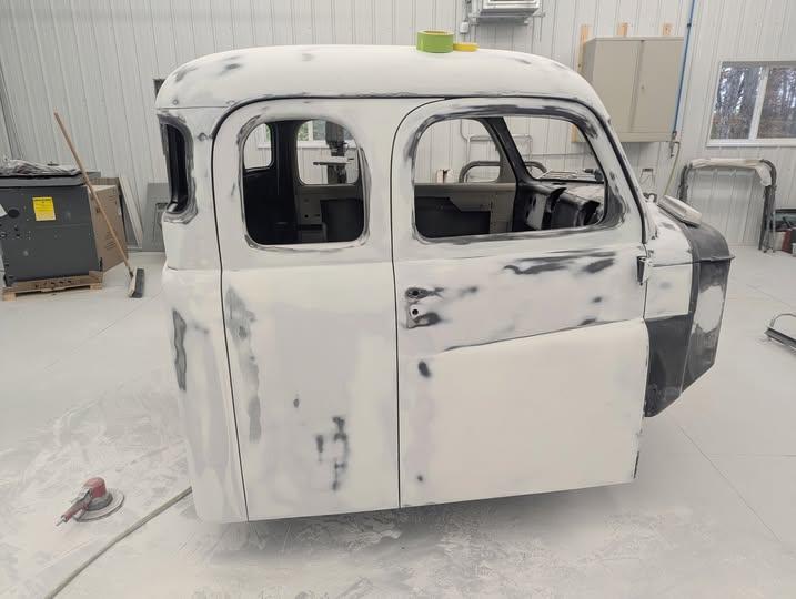

Well, wood projects wrapping up for the winter.  After almost a year, I'm getting back to TODD.  Last night I cut all the bracing out I had in for the roof build.  Now I can weld in new bracing so I can cut the floor out.  Then I will weld in new sill beams (2 X 4 x .125 tubular steel you can see them laying in the cab) and some cross members.  Hopefully in Feb I will be pulling the 94 into the shop and start tear down so I can get the cab set this spring.  Sure opens the cab up inside!
Edited by PilotHouse2500

sill/rocker beams in and seats out of the donor (and my helper)
