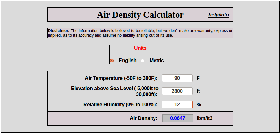

When I did the calculation on this back in the winter time the difference is like 2-3 PSI difference from 0*F to 100*F so the change in 02 isn't that much. No different that going from sea level to about 5,000 feet. I'll see about find my air density calculator again.

post-1-0-02237000-1402697016_thumb.png post-1-0-71489500-1402697014_thumb.png
A whole 0.0046 lbm/ft3 difference I really doubt the air density difference. I get more change in air density in elevation that I do in temperature.
