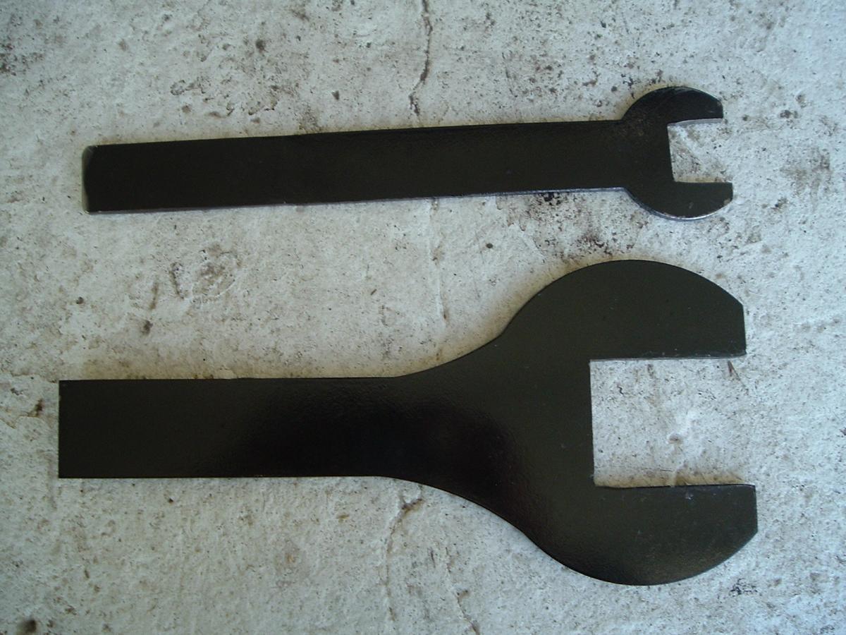

I had my radiator removed and front gear case cover off in 2 hours. Actually more like an hour and a half because I didn't have a 36 mm wrench to remove the fan so I took a spare 1-1/4" wrench and carefully ground 4mm out of it. Just kept checking it with a set of calipers and took a hair over 2mm off per side of the open end. That took close to a half an hour.
Sometimes they can be a real bear to get off! I got really lucky and it only took a couple of good smacks on the end of the wrench with a hammer and she came right off. There have been other times where I have not been nearly so lucky though.
You got pictures of this holder Mike? I have a few ideas on making one but would like to see what you have.
Sure do...
