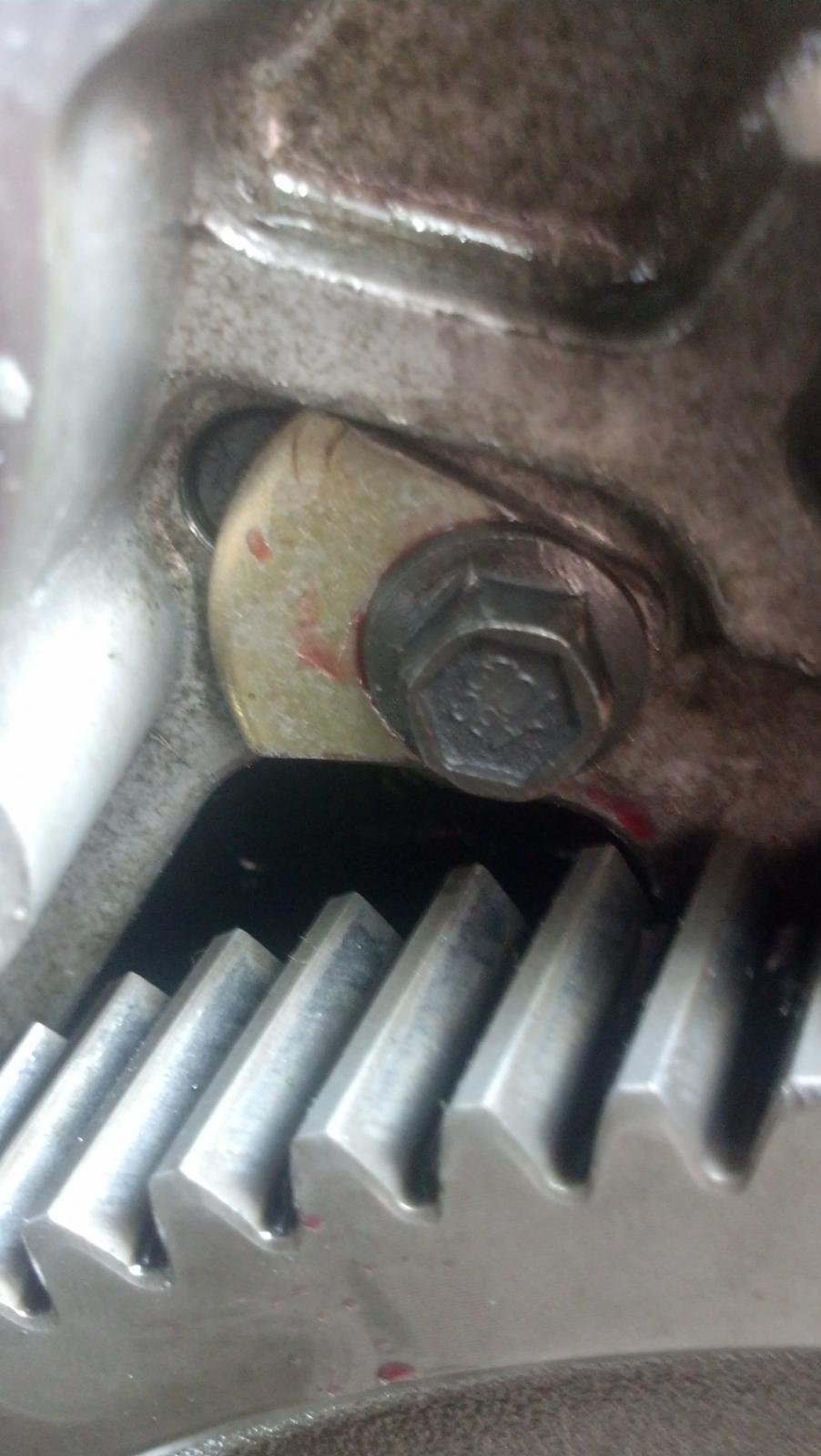

My 98.5 had it. All you need is a 5/16 fender washer, and grind it down to fit in the corner of the casting. Be sure to use Loctite on the bolt and torque the case bolts to 18ft lbs.

What does the OEM non killer look like?
look at my post above with pic. the casting is different partially covering the hole
You can't tell by looking at the timing cover. The only way to know is to pull the cover and look.
