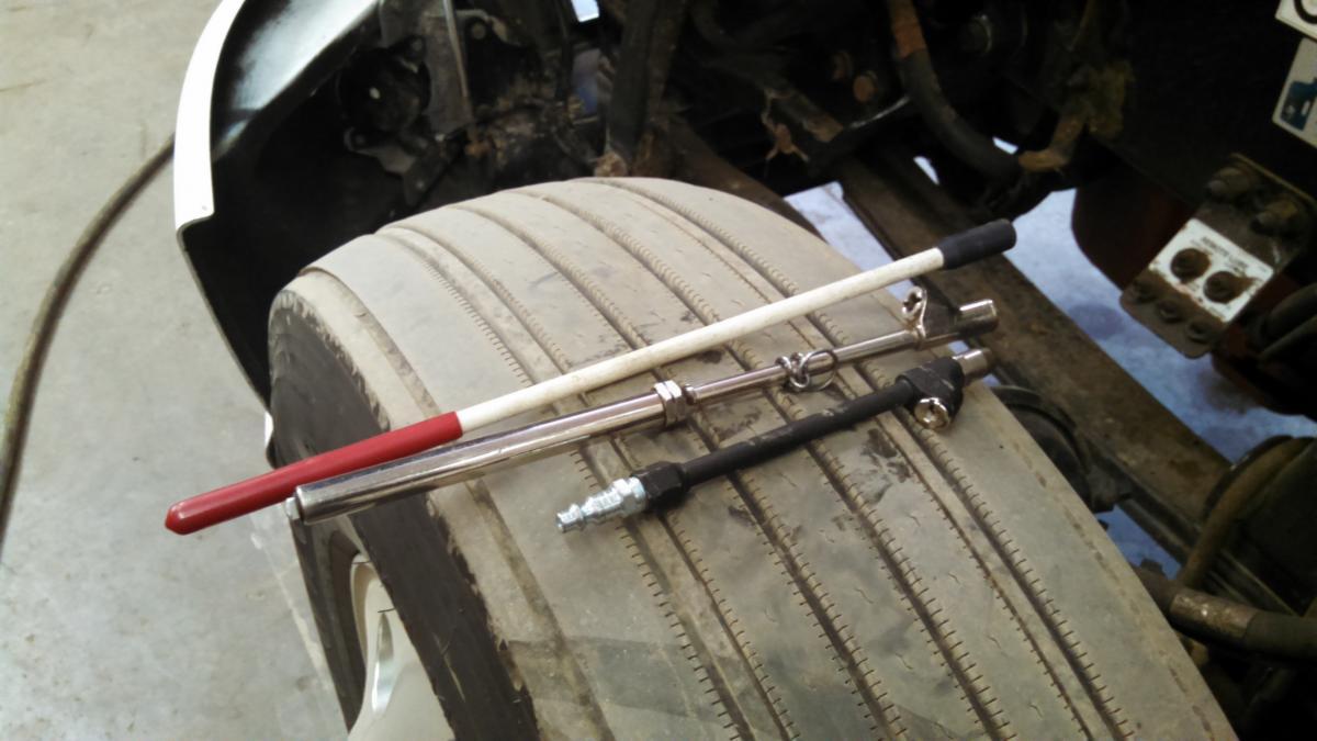

This is what I use every day at work to check pressures and air tires up on semi trucks and trailers. It's a valve pal for taking the valve caps off, then a 7" air chuck, and a long pressure gauge.

I like them and would get a set but the hubcap type simulators I have there isn't a place to mount them. Now if I ever run across a steal on a set of alcoa's I would ****** up a set real quick. I'll keep that link for future use.
