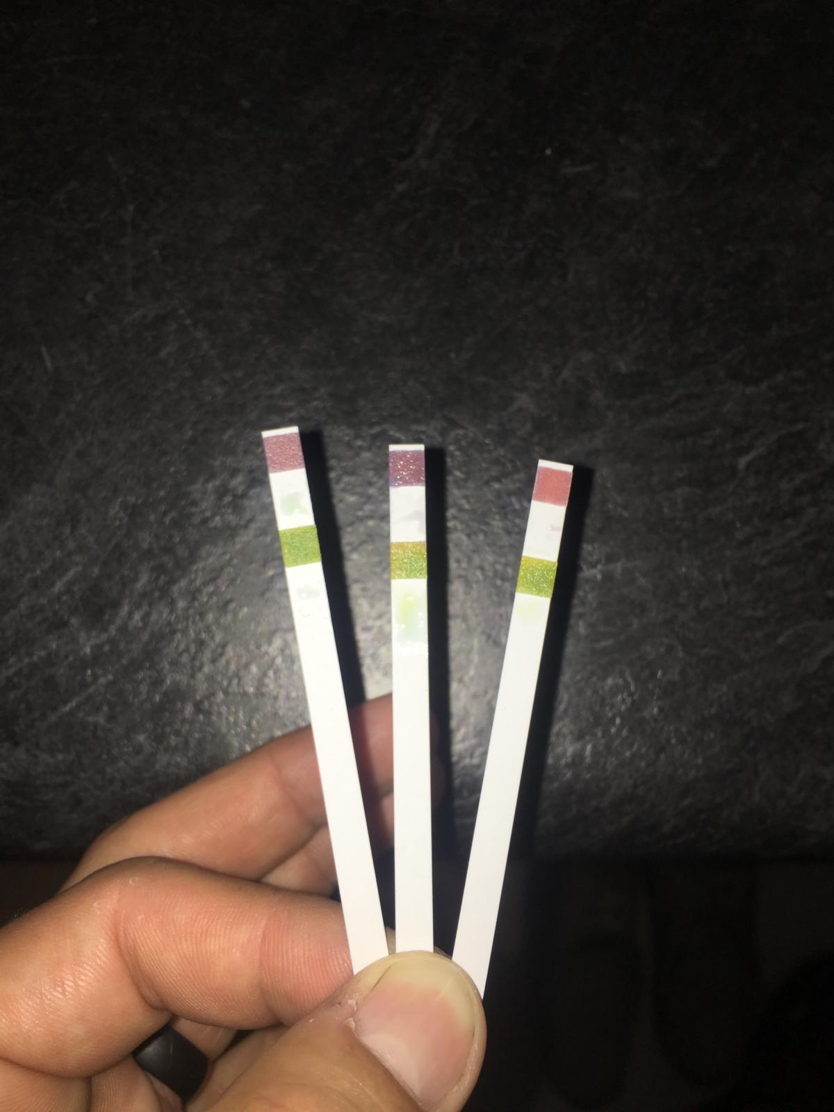

What should the PH be at with those strips? got some today...
From what can find, 9.8-10.5 is optimal
Well I have some interesting results to share. Below are (from left to right) tests from my 04 Honda Civic 202K, 06 Honda CRV 150K, and 01 Cummins 258K. The Civic we have owned since 150K and it has never had a coolant flush other than what came out when I replaced the radiator 2 years ago. The CRV we have owned since 117K and it was flushed at the dealer when we bought it. My truck I have owned since 248K and the only change it had was when the radiator was out at the shop that did the front main seal. I do know that the PO did a thorough flush when he did the headgasket and changed coolant from red to green. He said he had heard that red eats headgaskets and didnt wanna risk it. Now obviously my truck needs changed because the freeze point is way to high, but the PH on all three is right around 7.5 - 8.....IMG_1079.JPG
