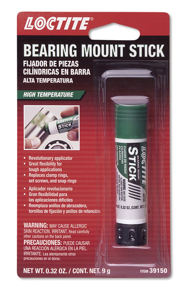

btw... i was going to use some of this between the crank and speedi sleeve, but from everything i am reading i am going to put it on dry.
thanks for being so patient with me. when you dont know, this stuff is scary.

Absolutely DO NOT PUT THE SLEEVE ON DRY IF THERE ARE ANY NICKS ON THE CRANK IT WILL CAUSE A PLACE FOR OIL TO SEEP THROUGH YOU NEED SOMETHING TO FILL THE IMPERFECTIONS..
That Loctite product is a retaining compound you need more of a sealant that will stay flexible like I originally posted.

I got some loctite 620 which is a liquid and fills gaps up to .015 vs .007 of the stuff i posted.
