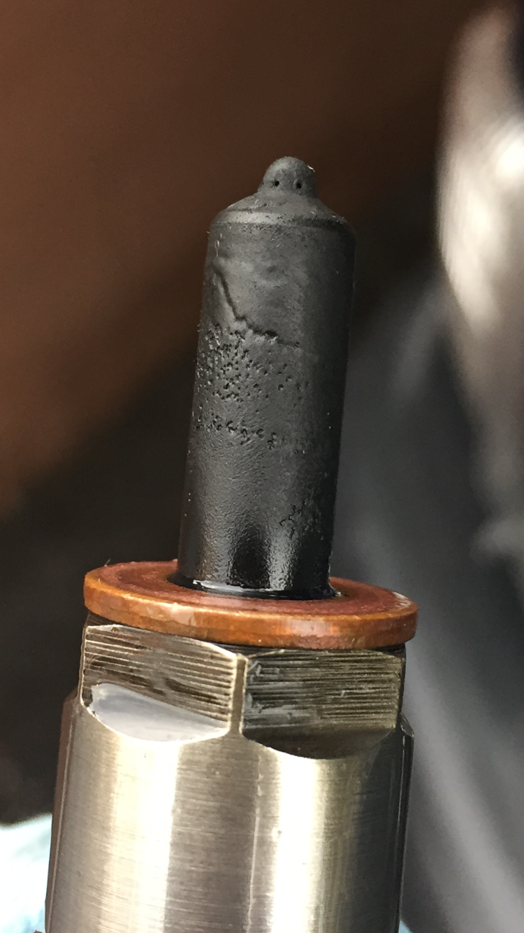

I got really bored over the weekend so I pulled two of my DAP injectors to see what they looked like after about 7k miles (I was really, really bored). Found lots of soft soot that wiped off really easily, and slight discoloration of the tips. Truck seemed to idle smoother with cleaning just two injectors. Curious. IMG_3883.PNG.d184c9c66f79e34fdd6cd4aa423a2c86.PNGIMG_3876.JPG.336de29d47d74fc9c8ad9cab57047769.JPG
