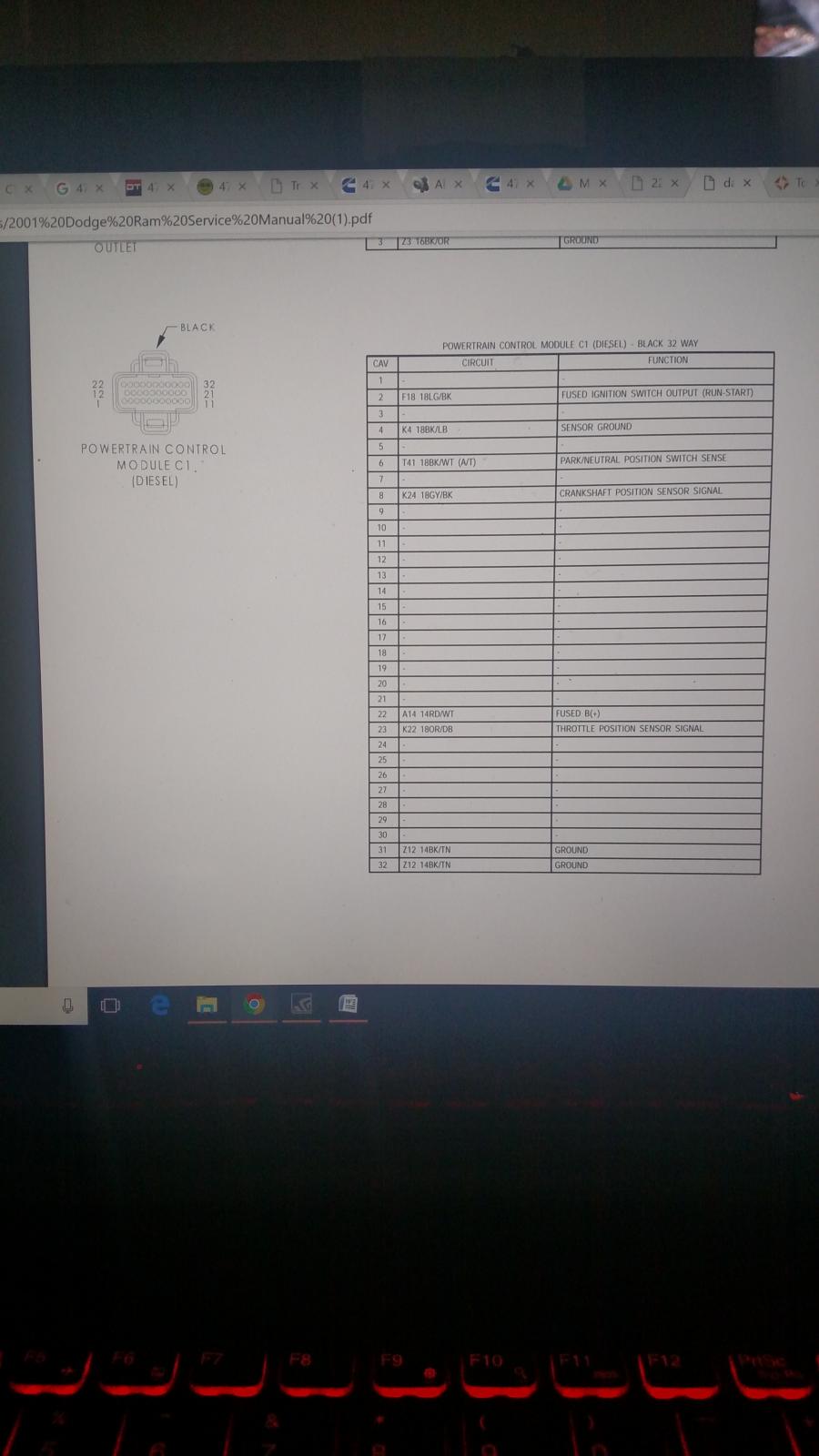

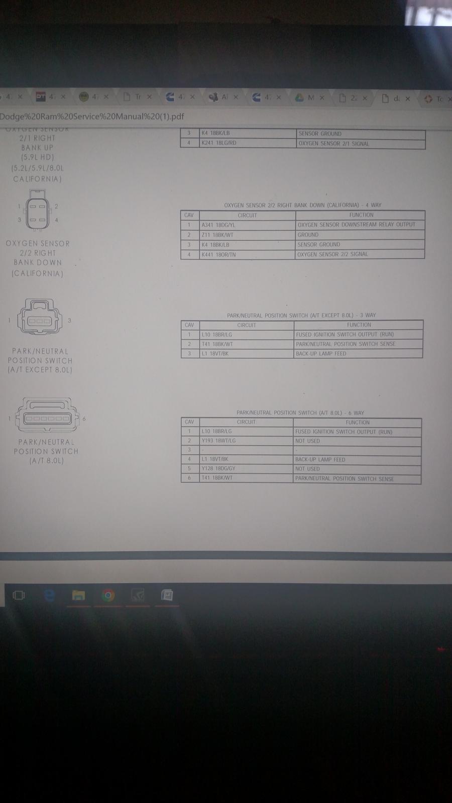

This led me to my idea, I crawled under the truck today and pulled off the connector to the neutral/reverse switch and found out which pin is for the neutral safety switch (its the top 2 pins). I then shorted the 2 wires together with a paperclip and went for a test drive. The truck went through the gears no problem 1-2-3-3lock-4-4lock as it would normally at all throttle positions, the lock-up switch still performed as it did before. I went into an abandoned dirt parking lot, put it in 4x4, and began to mash the brake and accelerator. The truck very quickly got to about 2500 rpm and about 30-35 lbs of boost. At this moment i knew it had worked. I built boost again and launched the truck, I had full fuel off the line with no bucking whatsoever, next I did a burnout with the same result. The only problem i ended up having is after about 20-30 minutes the truck threw a p1899 code for the switch being shorted which defaulted the computer and turned TM back on. However if you put it on a toggle switch you would be able to turn off TM at any time, and shut it back off before the computer knows while retaining all your gauges vs other options out on the market. Also if the neutral switch is "On" you will not be able to use cruise control so a switch would be the best option.

@kzimmer It will be as simple as getting a solid core wire and connecting the middle and top pin, I used too small of a wire and it came disconnected and i got confused for a second why it stopped working :poke:
So this is why it stopped working after 20-30 minutes and set a MIL? With a better connection it's all good permanently?
I wonder if there could possibly be any other repercussions of the ECM/PCM thinking the truck is in park/neutral? I must admit I'm a little titillated.
Posted (edited)
@kzimmer I think it was due to the amount of driving I was doing. It obviously wont throw a MIL at idle for 3 hours straight so i believe it was the combo of high oss speed (like 70 mph lol) and the neutral being 'on'. The p1899 is literally a code for the malfunction of that switch. I did happen to get one other code which was p0500 which is a vehicle speed sensor malfunction. Either i accelerated so quickly it got pissed off or its a result of the p1899 code. Both codes showed up at the same time. I have not seen any down side to having it wired on in all my testing tonight (besides lack of cruise but if its on a switch that shouldn't matter). """"" Re reading your post it did not throw either of the codes till it came disconnected from the best of my knowledge, ill make a more permanent setup and test it tomorrow and get back to you""""""""
