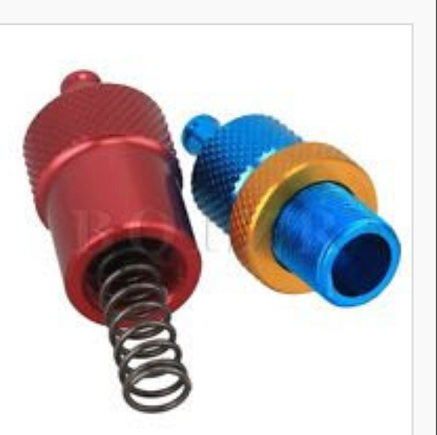

I just got rid of my boost elbow and installed a manual boost controller recommended by @kzimmer.   It's the best $5.46 I ever spent on this truck.
Now when I mash down on the go peddle the boost gauge jumps to 26psi, trans shifts up and boost goes to 28psi.  When it shifts to 4th, boost hits 30psi and speedo saying 80.
No more boost bleed off.

There is a lot more room on the adjustment for more boost so how much more boost can I dial in and still be safe?

  • This is the link.  The part comes out of Hong Kong.  When I ordered it the delivery date was posted to be 3 to 6 weeks, it came in a week.       https://m.ebay.ca/itm/Adjustable-Manual-Boost
  • I mean....if you are handy with a drill and a tap anything is possible....
  • A pair of tin snips mitigates this problem... Ask me how I know, haha.   Don't cut the spring. If you are looking for more boost, assuming you have enough fuel and don't have any boost lea

got to be dumb.  What exactly are we doing with $5 part. I believe I have a stick shift stock turbo on my automatic 98.5 truck. I have a hose that comes off the turbo and goes to what looks like a vacuum chambe with a rod. How can I benefit from this modification??
Basically controlling the pressure getting to the wastegate. So if the hose was directly connect to the wastegate it would be open by 20 PSI and it quits building boost. This little 5 dollar part is going to regulate the pressure getting to the wastegate so the wastegate stay shut longer allowing you to build more boost. This does create more power.
HX35W has a maximum limit of 35 PSI
HY35W has a maximum limit of 32 PSI
Beyond this your hitting the choke point of the turbo. If you had a drive pressure gauge hook up to the exhaust manifold and the boost pressure gauge you would see the drive pressure rising faster than boost which is the choke point and EGT's just take off from there.
thanks so much for getting back. So this adjustable pressure valve will adj. the pressure going to the wastegate allowing for more boost.   Will this effect the engine getting too much pressure when you quickly get off the throttle and you hear the the waste gate open and can that be a problem
