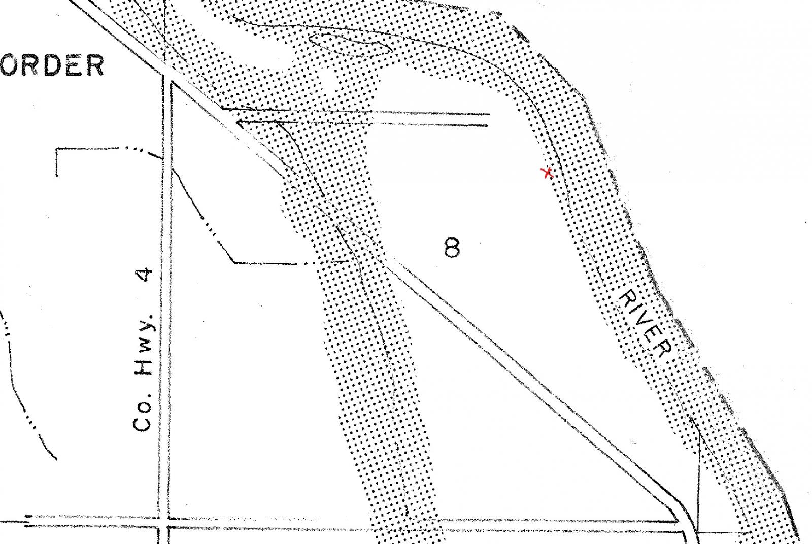

USAA is telling me they want flood insurance on the place due to the property being within the 1988 flood map zone 1......
X marks the house.
I went out with my GPS to plot altitude and the house is no less than 25' higher than the river accounting for GPS inaccuracy.  there is a clause in the agreement that says I have the right to have a fema rep come out.  Giving that the above map has my back yard in not a flood plain but the house in a flood plain even though they are at the same elevation I think Fema will be on my side.

Kind of like us. The 1996/1997 flood was high enough to cover the highway but the river was long ways from us. River flooding isn't the problem but the mountain run off is the problem. We are not required for flood insurance. My guest house / shop has been flooded more times I care to count.

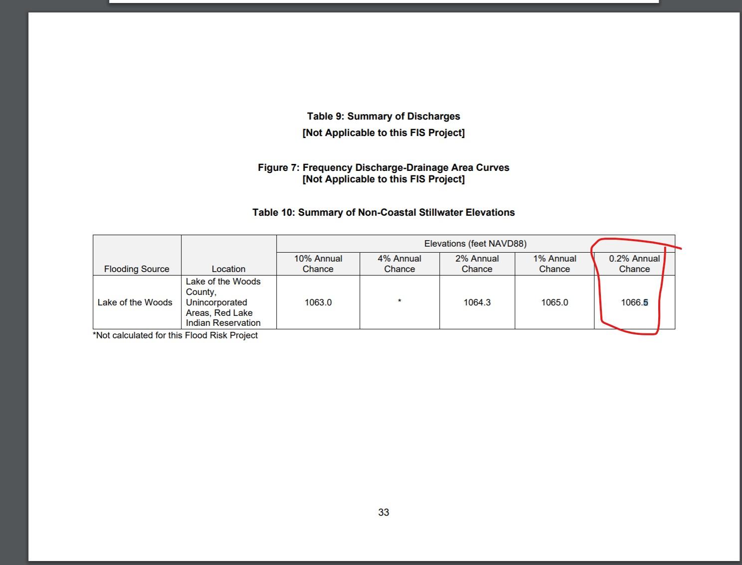

That's not bad odds for chance of flooding. Then add how much higher the floor elevation is. We got a permit to build in a flood zone on a river and had to build 12 inches higher than the 100 year flood elevation established with a spike the county surveyor drove in a nearby telephone pole. It wasn't a problem. sounds like your at a safe height.

I very much think the house is safe, however convincing the bank might be a different story
I've built two homes on flood plains and both had to be just 12 inches above the hundred year flood mark. They were no problem for the county nor the bank loan approval. You may have to invest in a surveyor to show that you are 12 inches above. Sounds like you are.
