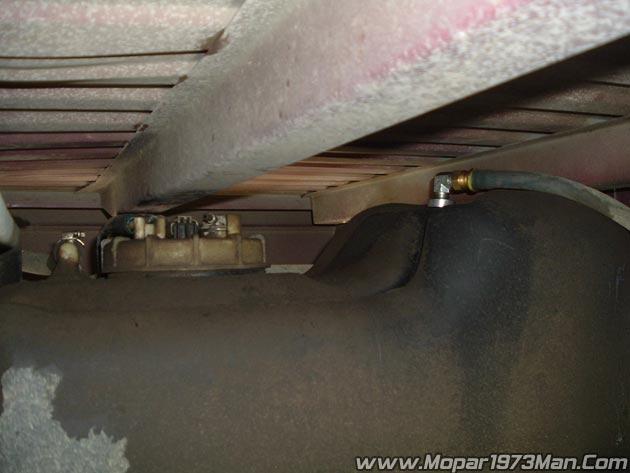

First of return pressure isn't a concern. The restriction is NOT the plumbing but the VP44. Look at the photo the return is the left side while supply is the right side. No matter what you do for the plumbing this restriction will always be in the pump and will not flow any more. My max fuel temp in the summer with temps between 110 to 115*F outside barely makes 130 to 140*F fuel temp for me. Still running fully stock return lines. The key for me is I do NOT draw from the basket where all the heat fuel is coming back to. I pull from the front side of the tank on a separate draw straw. For all you drawing from the sender basket remember the return from the rear of the heat is heating the fuel to near coolant temperatures and then return to the sender basket to be sent back to the VP44 preheated. Again where I draw away from the heated fuel and get cooler pump temperatures.
