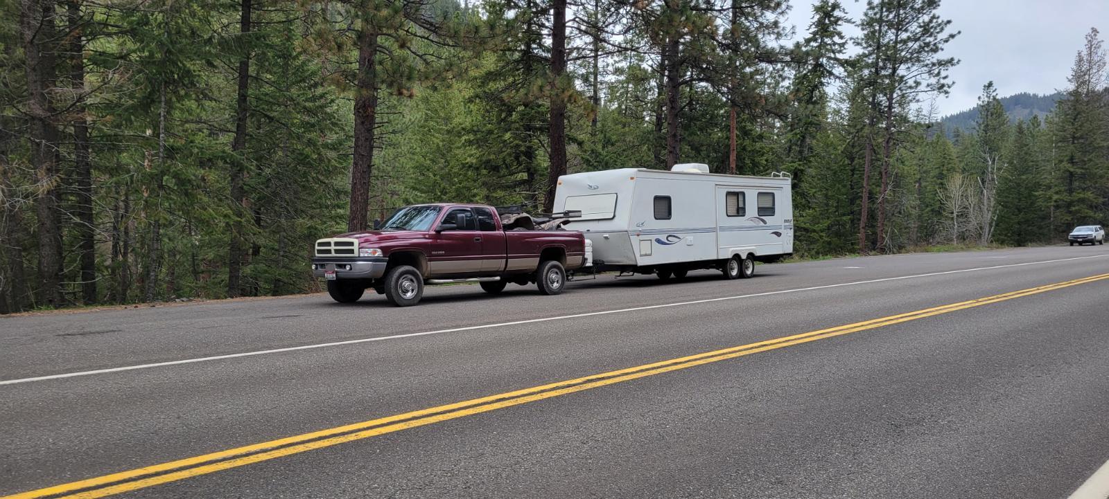

For 50 HP injectors stock turbo should be fine. I'm running 150 HP injectors on my stock HX35W (54/60/12). Climbing 7,500 into Bridgeport, CA. No EGT issues at all. My biggest problem was transmission temp that was running high from head winds. Total weight was 17,500 pounds. Boost limited to 35 PSI. Again my final ratio is 3.69 running on 245/75 R16 tires. This is the huge part having proper final ratio. Might be pizza cutter but no EGT issues.20220505_140338.jpg
