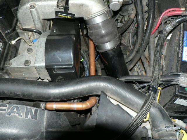

Look in my pic, I just did this mod last week with a boost bolt. The pvc sets just above and the the left of the boost bolt and doesnt bother it at all.

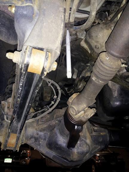

My truck has 285,xxx and i don't have any blow by or any oil leaks and it still has the factory puke bottle, i still wanna do this upgrade though just for peace of mind, my only ? is how does this look where it comes out at the back of the motor not really any pics of that part just the top part on the motor.
Depend how long you cut the down pipe. Mine is about 8-10" above the driveshaft and I want to cut another piece just a little longer.
I will try to get a couple pics of my vent setup along with the end near the rear of the engine and where it drops out. Should be able to upload them tomorrow.

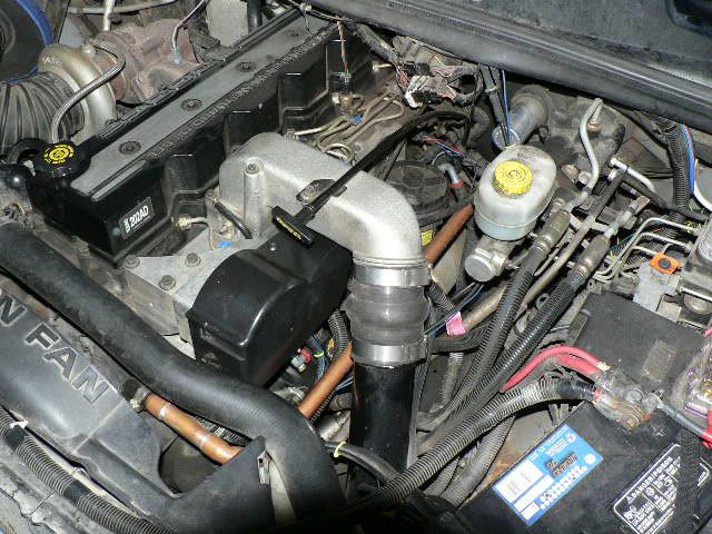

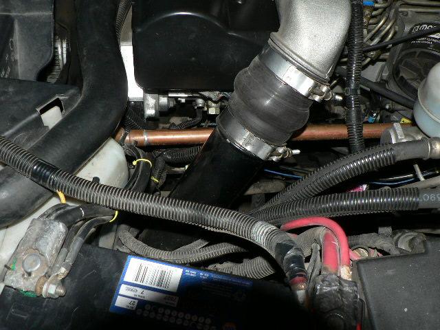

Here are my pics. I got some of the vent end near the rear of the engine - it exits almost above the front pinion.I used my stock rubber hose from the puke bottle... I cut off the "U" portion and turned it upside down to go around the radiator hose. I used slip 90's and glued everything but the last connection before it goes down, that one is a threaded 90 so I can unscrew the down-tube portion if I need to pull it out.post-11826-138698190761_thumb.jpgpost-11826-138698190777_thumb.jpgpost-11826-138698190782_thumb.jpgpost-11826-13869819079_thumb.jpgpost-11826-138698190797_thumb.jpgpost-11826-138698190802_thumb.jpgpost-11826-138698190808_thumb.jpg
