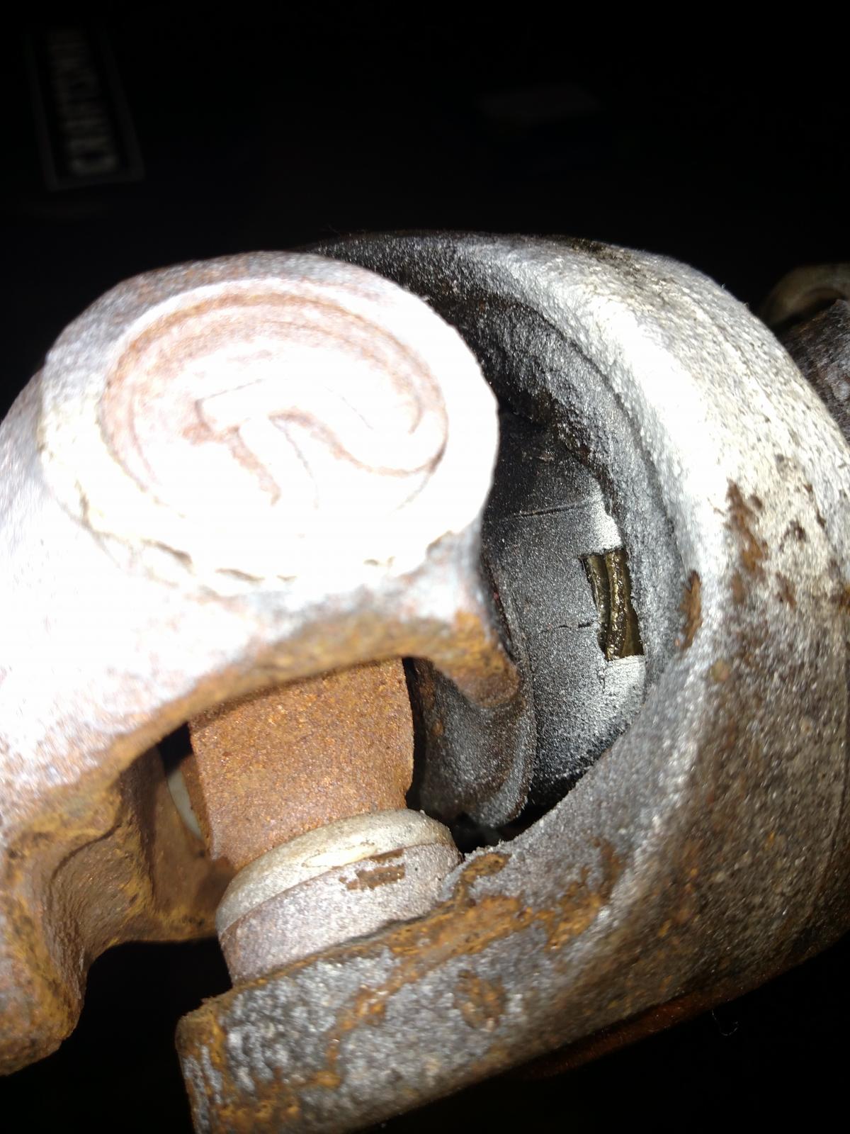

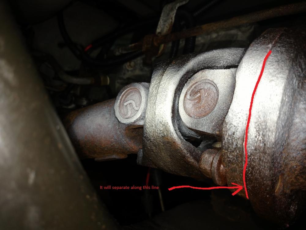

  • There is a bushing in the tail shaft of the transfer case.  This is pretty important, and is often overlooked.  It allows the yoke to "rattle" (for lack of a better term) on the output shaft.  I have
