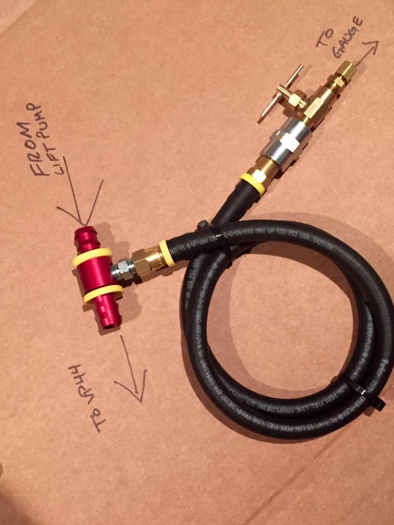

I'm thinking of running this setup for my fuel pressure gauge. This is how I want to tap into the fuel line.
image.jpeg.95bce706e8cd5696e34eac7f618ae
Whatduya guys think? Will it work? My idea behind this is to mount the needle valve in a more conviniant spot. Since I'm not using the stock fuel filter housing I figured I'd try mounting somewhere that works better for me in case I have an emergency shut off situation.
Pics coming soon and more to come!
  On 3/3/2016 at 2:10 PM, Mopar1973Man said:
I would of mounted the needle valve right at the tap point. Now when that hose failed your going to be stuck with ZERO way to shut down the fuel.
But how often does hose fail?  there is a lot of hose in his fuel system before it gets to that tee.
Both valid points for sure. If the hose failed I think I'd be getting a tow regardless. I'm more concerned about being able to shut down fuel leaking into the cab quickly if that were to happen.
