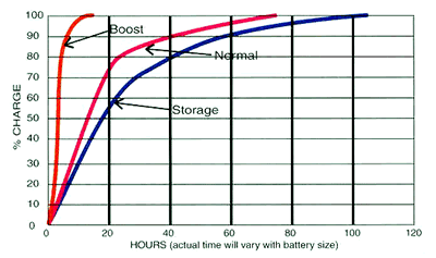

Computer power supply is not going to charge at different levels of voltage for different times. Like boost or desulphation mode is 14.3 volts for a period of time, the normal mode is 13.6 volts, then storage is 13.2 volts with a desulphation run every 24 hours. So a PC power supply will provide a perfect 12.0 volts and nothing more.
http://www.progressivedyn.com/charge_wizard.html
How the intelipower changes voltages for the needs of the batteries.
Charging rates...
