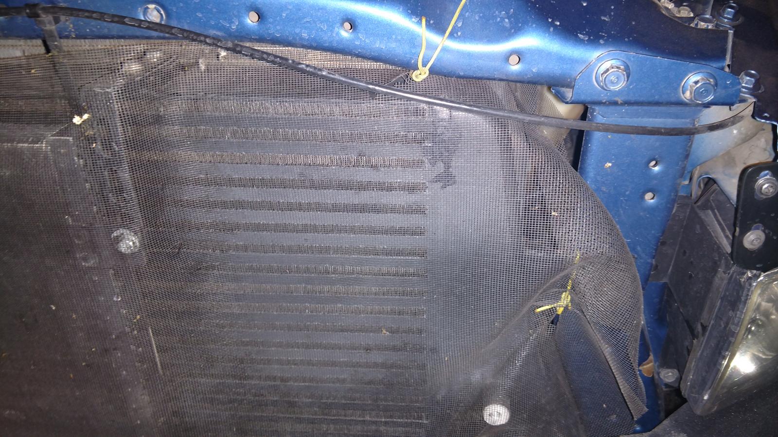

@Taz I've had to flush the face of his radiator twice now. He was having overheating problems. I've got to pull it completely out some day so I can really flush it right. I not able to really get all the mud and bugs out of it. This is even on a 3rd Gen truck. I've got to wash mine down weekly from all the bugs and road miles.
No bugs, no rocks, nothing gets in here. Cheap and easy to do!

Tyler, TFaoro, I do the same thing with a piece of screen on mine. I can shake all them bugs right off the screen. Need it on my 01 thanks for the reminder to do thiat

Make sure not to use metal screens. They will eat into the tubing and coolers if you not careful... Ask me how I know. :duh:
If you do put the metal screen on your grill not the coolers much safe and less damage.
Plastic!!!
My dad's has been on since 96. The condenser still looks brand new at 180k.
