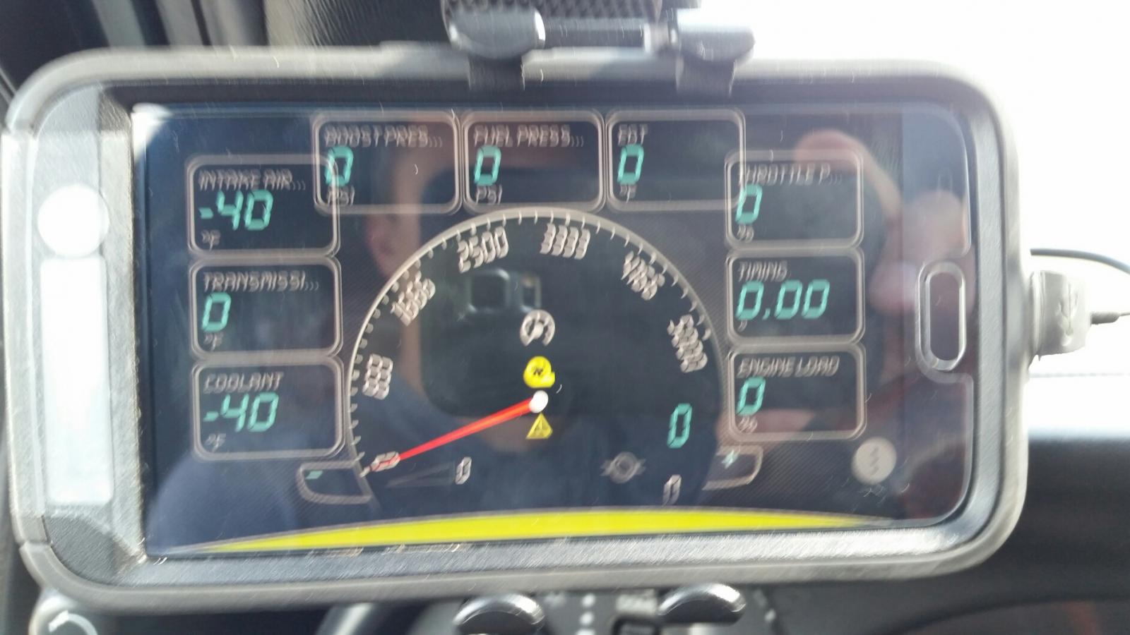

So now driving home and app froze up I can exit and load it again push connect to adrenaline and it shows all zeros, never done it to where I couldn't restart it5983975ea054e_2017-08-0316_27_59.jpg.5ec3f4e25d4fd8574c814e3cb2c9175d.jpg
Tried unlink link with different phones, same thing, flying blind

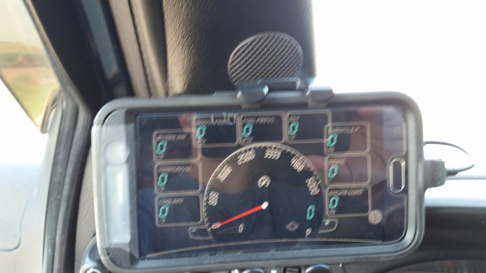

Edit, after few attempts to load a tune screen now showing this
Edit got to a place where I could shut the truck off and it loaded up till I got home and it froze up again AZ I was pulling in driveway, is this same that you guys expiriengnceing
Also when it froze I could still load tunes I belive, because I can hear difference it timing when I was on hwy, it just wouldn't show anything on screen. And so I left it on default tune and when it started to work again that's what it was on, so it must be working in background just doesn't want to display it.
