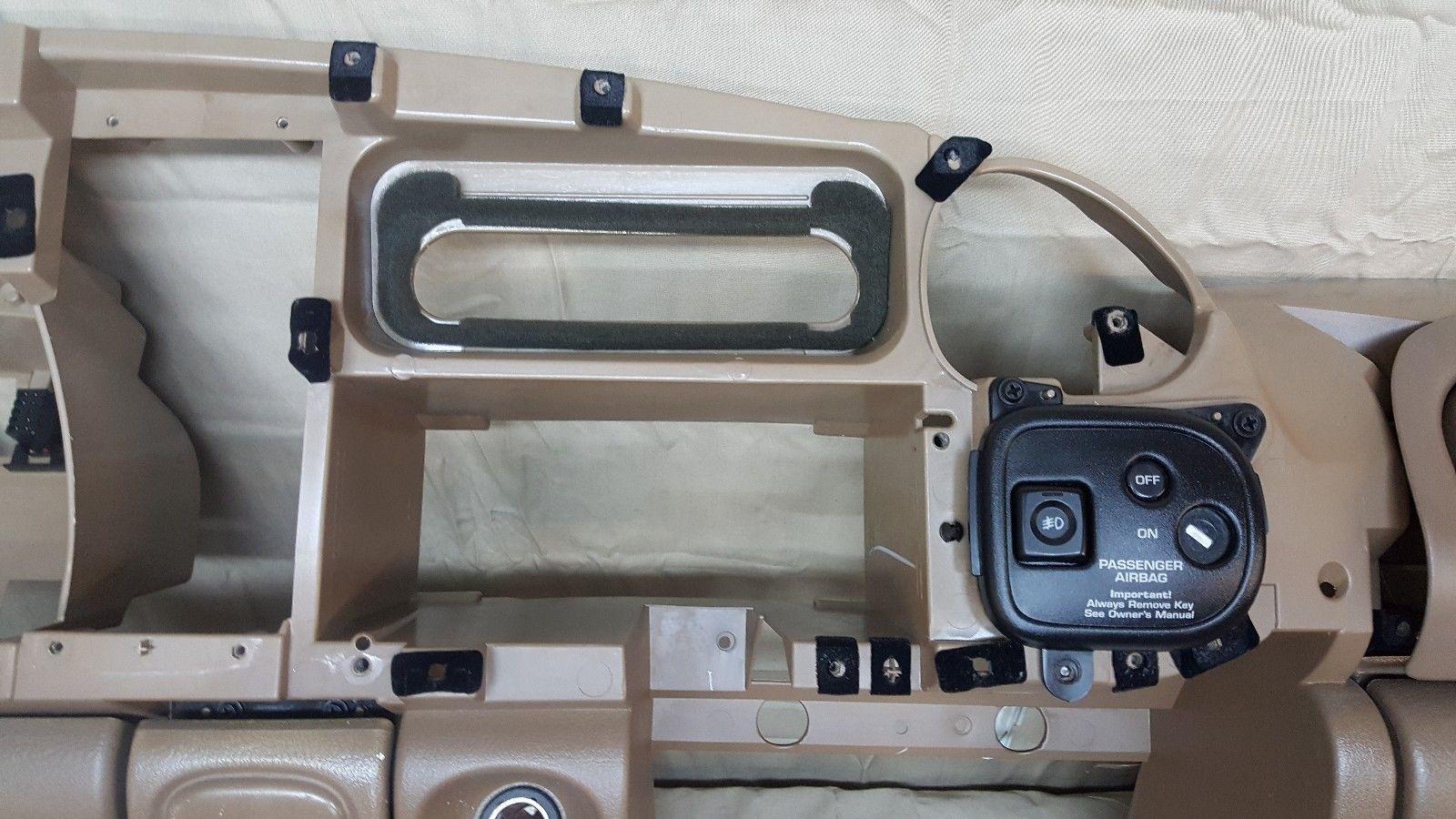

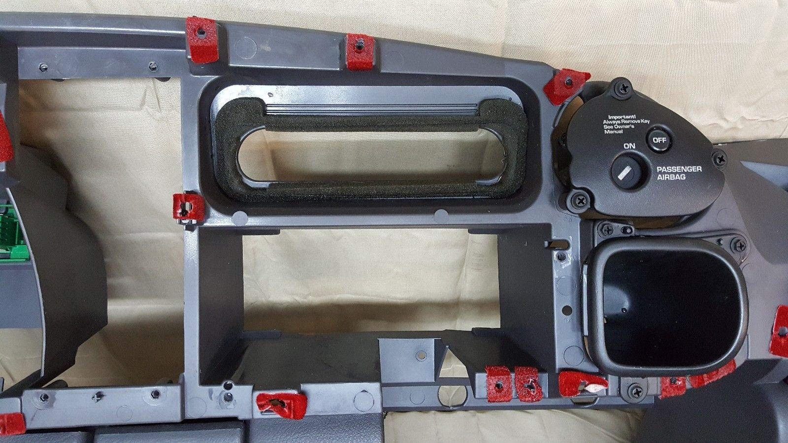

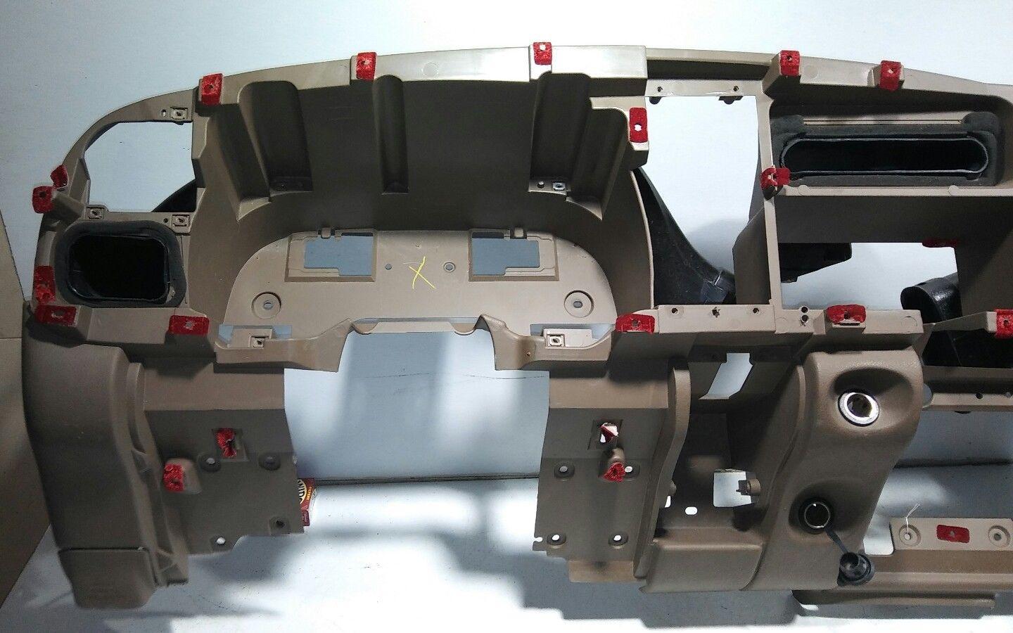

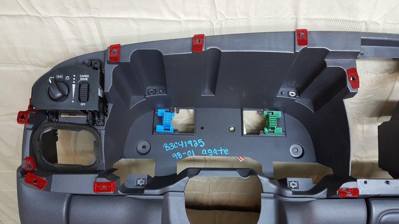

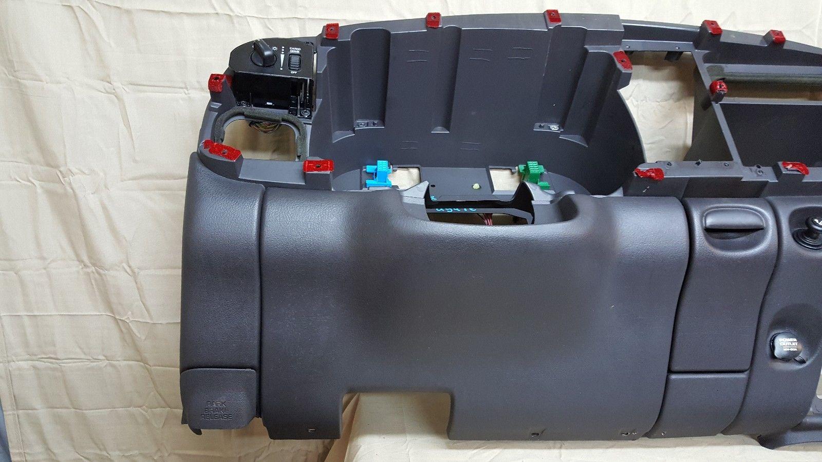

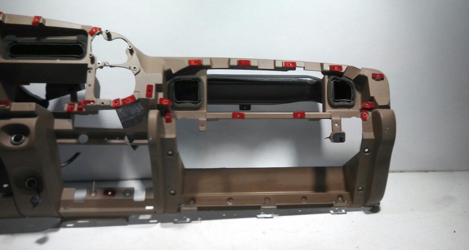

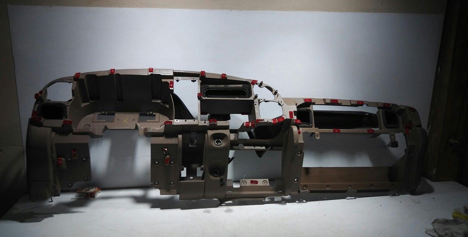

This is just a heads up for those folks like me who have the inner dash fame core mount deck assembly broken. I have been trying for several months to locate one and found some on eBay but a complete unit may run from $550.00 to $800.00 depending on the salvage yard that is selling it. Getting pieces from one that might be broke or ruined when removing it doesn't fly either. I have offered to pay a good amount for the broke pieces I need to glue back. With all the glues out there now that work excellent on plastic to plastic or alum or to carbon fiber it would be worth the while to give it a try. It's better than looking at your head light switch hanging or the A/C protruding outward from the top support piece missing and so on. But bottom line is the item is called by the title of this thread. Hope this will help some looking or have had their trucks broken into and the dash tore up in the process. I have some pictures of the complete assembly for a 1998 Dodge Trucks attached. I haven't posted pictures before but they are listed below under Attach Files. Hope you all have a Blessed and Prosperous New Year.
These photos might help if you are trying to rebuild your core and need to know what the original shape of it was.

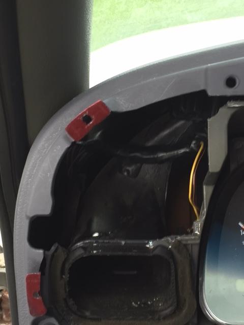

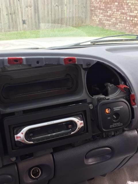

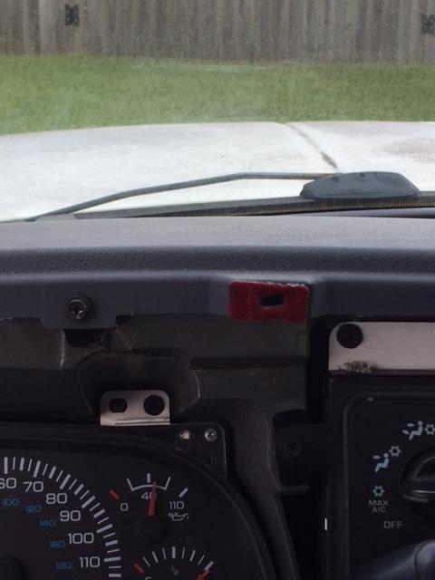

Been gone a little over a week, started this before I left. One thing I found out about the Dash Cores being sold is the shipping is crazy. Anywhere from $300 to $400 added on. I'm getting my 12v for sale but the dash is broken all the way across from door to door. I had glued several pieces of the Core back in but too many pieces missing to do a good job. Another screwing. This truck must have been in a head on, Air bag plastic, center dash plastic where the A/C controls screw in, dash cluster has several breaks, and last the head light switch has nothing to attach to. All good things come from above including all idea
IMG_2625.JPG.768cba94ceee923d44d9049cc6439632.JPGIMG_2623.JPG.7f98b80e25ccdf58c6e884387c0c5c03.JPGIMG_2622.JPG.e109d89b2e986034f984be6ba5b4f8ae.JPG

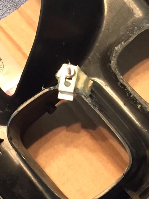

3 pictures of what I am working with, didn't want to load a pile of pictures so I picked to one's that showed the basics. Next is the new Bezel I bought and a way to attach the Head Light Switch directly to it so would stay
in place.
IMG_2552.JPG.193a78dd5d42591847307a6fb8f1aef8.JPGIMG_2557.JPG.6bb6f2f373662bb0a766d2a47328f658.JPGIMG_2556.JPG.53c6c4652ea9b7797573af33c8d147d1.JPGIMG_2555.JPG.6fe73986e24a6930ea90fbeef6248a2d.JPGIMG_2554.JPG.9a9526bbd446768b2010cdb22d37b2a3.JPGIMG_2553.JPG.213152544b6f5e91e170061538db482a.JPG

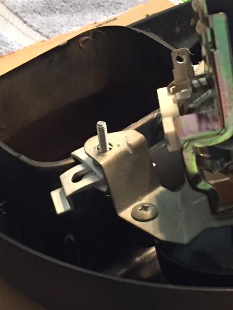

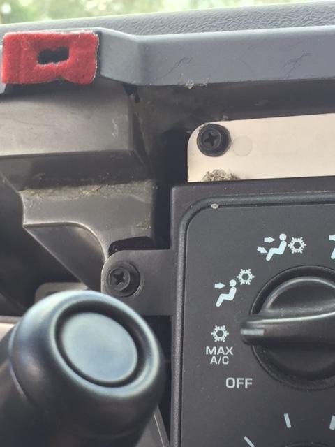

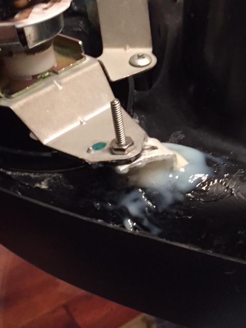

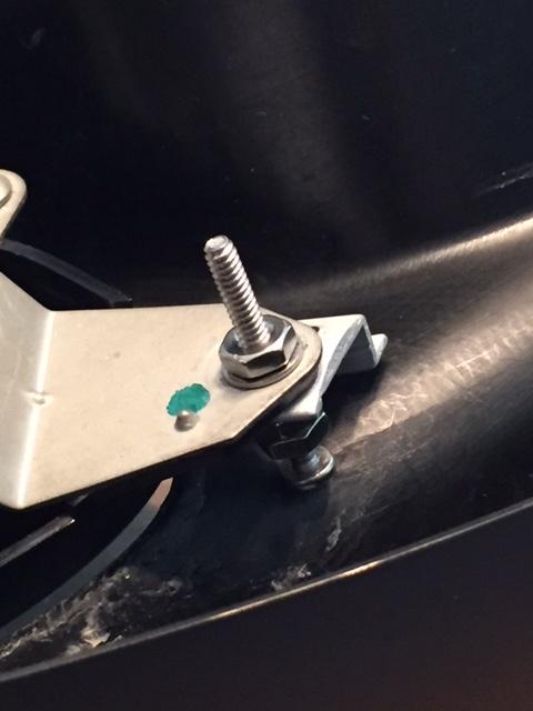

Screen door parts and some #8x32 screws, nuts, and washer put together to lock in on the edge of the vent. I used the bolt pattern on the light switch to center it before tacking it in place with the glue.IMG_2558.JPG.cf6f416d4c90321e64220df0047a2a8a.JPGIMG_2559.JPG.c68f88a1d6a5c720033f1f84775d3c51.JPGIMG_2565.JPG.baab2500b10e9e6d986dceb4baf1f4a1.JPG
Enough glue to hold it in place and more added once it set up for about 10 minutes. All the glue running down the vent is from using the Gorilla 2 part glue. IMG_2568.JPG.892141066c645244c6346634b29b87c1.JPG
i used the screw to set the distance so it would touch the plastic Bezel holding the correct height. By no means am I saying do it like this, I felt blessed to have an idea that made it possible to have a functional light switch and not one hanging by the wire harness that took 2 hands to work. It's solid as a rock too.IMG_2571.JPG.95d0a0bebcf329bdf50d34dfd6d2e555.JPGIMG_2572.JPG.2aa4ea9c643c781aa1d72eb1ee5c4ad4.JPG

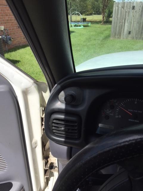

Installed back on the dash and it has a completely new look, NORMAL.
I had to keep flipping it over to check the switch bezel (?), don't know what it's called, but with it in place the rest was easy and fell in place. I made sure I got plenty of glue on the hardware I needed to lock in place but didn't risk over tightening.
Back in the truck at last. It looks NORMAL for a change and doesn't raise a lot of eyebrows. It's the best I can do and wanted to share it with the Forum in case others might be looking for a way to solve a similar issue. Thanks

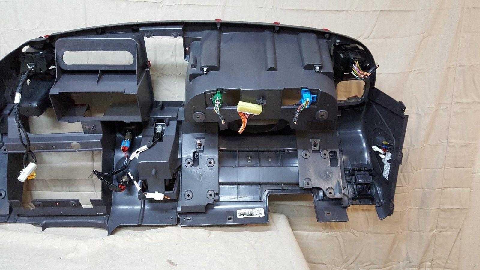

I'm in the same boat right now, my head light switch is floating behind the dash and my HVAC controls are barely holding on.  I keep watching for a dash core on ebay within 500 miles which is about a tank of fuel.  I'd rather spend a day and $120 in fuel to pick it up than $4-500 to have it shipped.  I'd rather see it in person first anyway to make sure it's in good shape.  Who knows what will happen during shipping.
Replaced my interior/ dash with a junk yard dash, from a u-pull-it yard,  I had the light gray interior but the dash was broken where the A/C controls mounted, was going to try and fix, but it was to brittle, New cover I got from LMC, ordered it in light gray before I figured my dash wasn't repairable (at least I was going to get it pieced together, only 3 hrs from KC so I drove down an exchanged for the Agate, so far I only have about $150 into the interior parts from the yard. I did crack the "new dash" slightly used some JB plastic weld, you can see by the light switch, but it's solid now.20180925_193535.jpg.daddf7a89fc9e5a230284af62ea5f90e.jpg

The wiring had enough give to lay it down, most wiring is clipped to the dash frame, only disconnected to completely pull dash, when installing new dash hooked all wiring back up prior to installing dash cover, then lifted onto bolts, also purchased new push in nuts for firewall from dealer, old ones were brittle.
